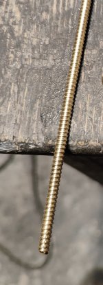

And when it comes to ordinary square nuts with finely beveled corners. This means shorter production time.
Here are examples of my work with various nuts. These are tailored to the specific period of the helmet along with the pitch and thread diameters. Making the threads took the most time. Such nuts are made faster because they are made of smooth sheet metal.

Dimension 1/8 is 28 coils per inch. I own such tools then I can advise something.
