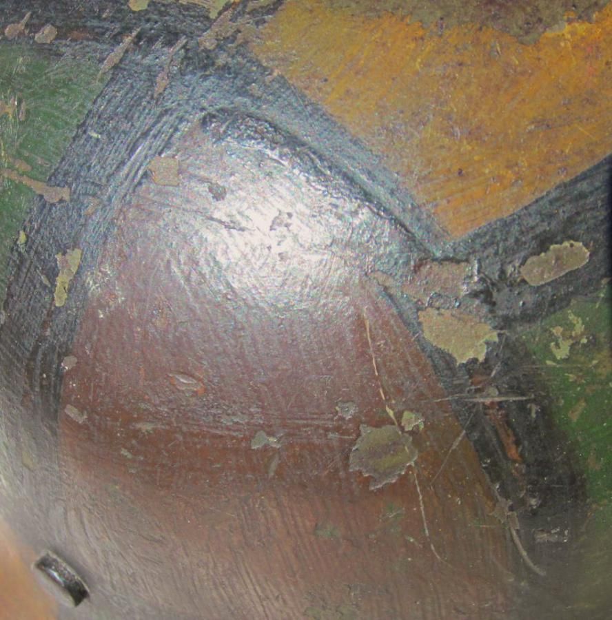

some pics. Opinions welcomed. John

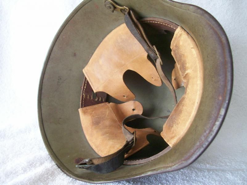

Post by JTD » Tue Jun 16, 2015 7:50 pm
some more

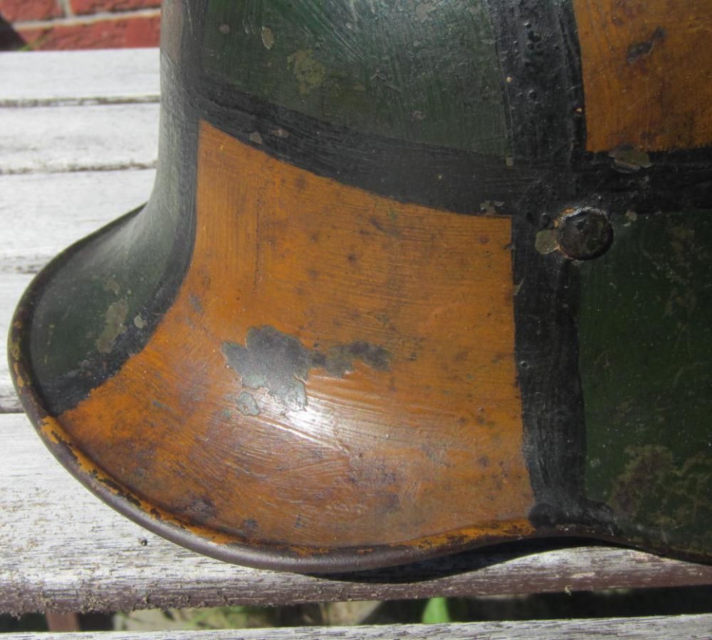

Post by JTD » Tue Jun 16, 2015 7:54 pm

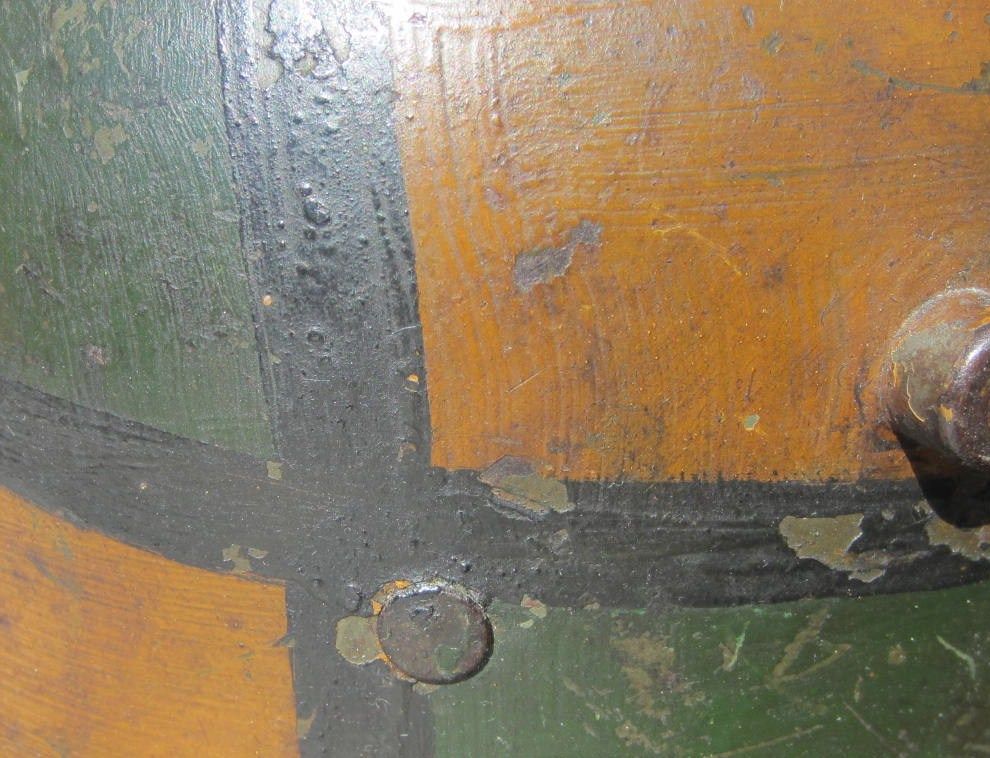

Post by JTD » Tue Jun 16, 2015 7:59 pm

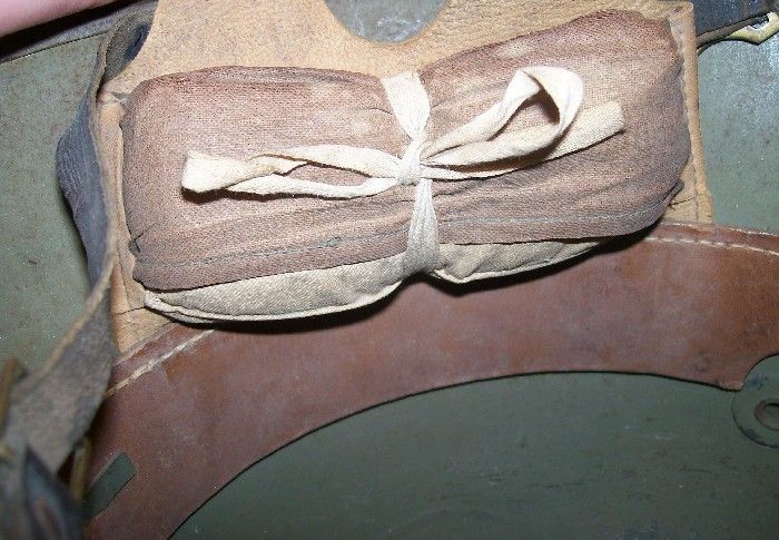

Post by JTD » Tue Jun 16, 2015 8:21 pm
Stahlhelm
Posts: 236
Joined: Sun Jun 18, 2006 1:06 pm
Location: Ontario Canada
Re: German Camouflage Stahlhelm M1916 with Totenkopf
Post by Stahlhelm » Tue Jun 16, 2015 9:40 pm
First thing to point out is that the liner pads are modern fakes. The proportions are off and the leather has been artificially aged with dye and who knows what else in order to make them look old. The leather that was used back then was either vegetable tanned cow/calf skin or the later off-white chrome tanned sheepskin. They did not dye liner pads brown. When you see pads with brown dye, especially on the reverse, it's a bad sign. The stitching is coarse and looks hand done. Original tan leather pads for comparison:
The interior paint on the shell and liner band looks like it could be original WW1 period going by the pictures. Not sure though.
The liner pins are well known round-ended repros available since at least the 90s and can still be found on eBay today. The paint that covers them and the helmet exterior has been artfully scratched and aged to look old and worn.
I have held this exact type of fake in my hands more than once. What they generally do is strip the shell, chemically darken the bare steel, apply the camo paint, and then chip and scratch it to expose the chemically aged, old looking metal. The scratches and chips all have an artificially and uniformly aged look to them, and this pops out at you right away once you've seen enough originals as well as fakes. You will notice that there is no factory applied field gray paint visible anywhere underneath the camo. It's an important thing to look for.
Compare it to these pictures here of an original camo. There are a mixture of newer scratches and chips as well as old damage. The factory field gray paint is visible underneath the chips in many areas, not just bare metal.
