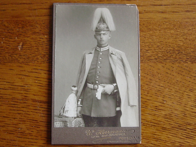

Here is the CDV that came with the helmet that is supposedly Mr. Weber...
Interesting the seller of the helmet at the SOS, stated he got the helmet, plume and CDV all together from a storage locker sale, who knows could be true.
Either way I am happy with the helmet and can hardly wait to get it back from Brian.
Interesting Mitre in the photo as well.

The guy in the CDV is not a dragoon, but is a great photo. Maybe the locker belonged to a dealer or collector.

it is a Grenadier (round visor) in the cdv - from Potsdam and with a mitre helm - 1st GRzF

Thanks to all for their kind comments. I wondered about the visor shown in the photo as well, nice to have other members confirm that this is not a Dragoner. I still wish that we could come up with some information on Johan Weber.

James ;
I also believe the photo to be of a soldier in the 1st Garde Regt. zu Fuss .
Great photo , but don't match with the helmet .
