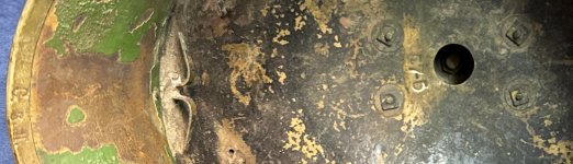

Looks like your helmet is issue marked on the central area underside of the front visor trim. I can see a "G" or a "C", an "8", and a "II", Roman numeral, I believe. On the far right or left underside of the front visor trim, there may or may not be a marking such as "G. R." or "G. K." I can't see if it exists, due to the angle of the photograph.
I also see a size ?57-5? (size 57 1/2) marking inside the dome of the shell. Sometimes these helmet shells are marked "G. H. Osang, Dresden" with a date, near the vent hole inside the top of the helmet.

Looks like I have previously pointed out that some of these Saxon helmets like this one may be found to be maker marked by G.H. Osang.
I recall that mine was not maker marked. I'm not certain that yours might not have a maker mark in it, like my former helmet. I've also seen examples maker marked by "C.E. Junker, Berlin".
I forgot to mention to look on the far right or left side of the underside of the front visor trim area. It is known that these Saxon helmets like this example can be found with the issue stamping in that location, with the possibility of a "G.R." or "G.K." marking and other numbers. Your helmet may or may not have such markings found in that area I mention to look.

The visor is stamped 55 and the tail is stamped 57 in the corners.
There are no marks easily readable inside the two posts for the spike base. But there is a ton of paint so it might be under there. During the restoration process i think the paint will need to be removed completely anyway and maybe we can see more.
I enlarged the original photo from post #1 of this thread, to show what is visible for the marking on the visor trim, and the size mark inside the dome of the helmet shell.
If it were my helmet (which it obviously is not), I would make certain Not to remove the black paint on the inside of the helmet, or the green paint. The green and black paint is original to the helmet. But you're the owner of the helmet, the choice is yours.
The black paint is actually only 1-layer thick. I can guarantee 99.9% That there will be No "G.H. Osang" Maker mark to be found if you remove the black paint. The black paint is not really very thick, and in all honesty it does not look like there was ever a maker mark in the top inside of your helmet, only a size marking which we can see is clearly marked "57-5" for 57 1/2 size. The paint is not thick enought to be hiding a "G.H. Osang" maker mark, in my humble opinion. It is not surprising to find one of these Saxon helmets with no maker mark.
