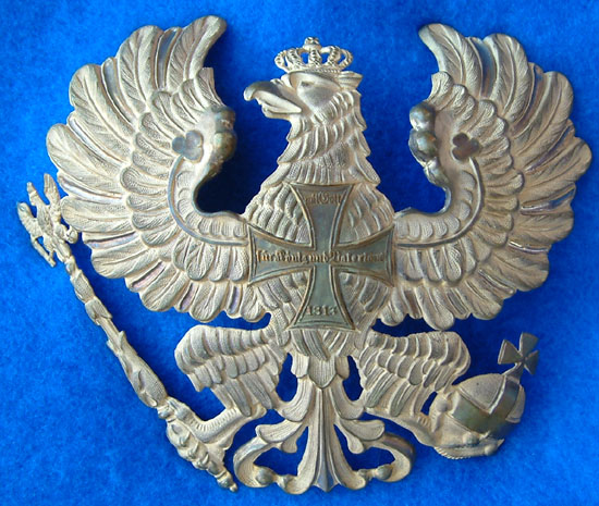

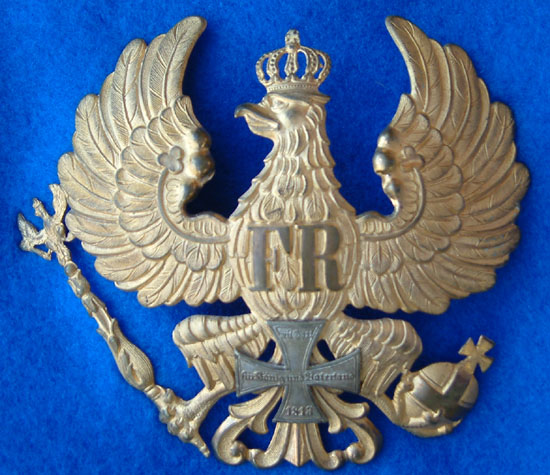

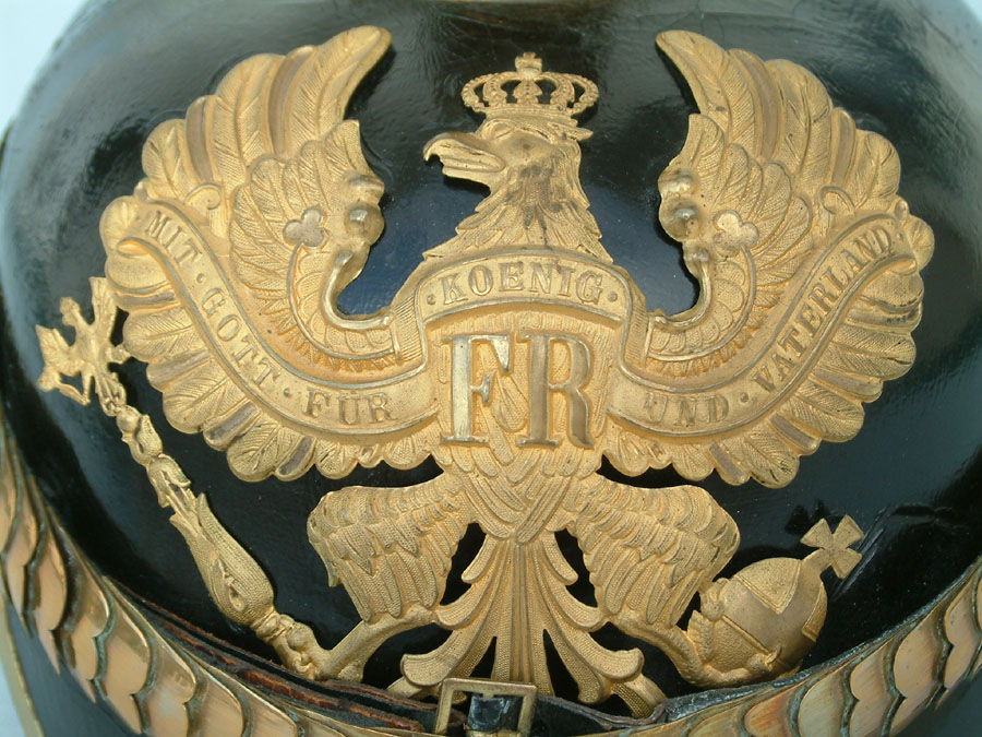

The key piece of knowledge is that for officers there were 3 kinds of basic chickens. 1. Line 2. reserve 3. Landwehr.
Line eagles like yours had a bandeaux and an FR.
Reseve eagles just an FR. the bandeaux words were on the cross.
Landwehr Eagles had only the cross.
I really should be cutting the lawn, but to add some photos to what Joe said......Line Eagle Wappen below with Bandeau and FR.
Reseve Eagle Wappen below with FR and Landwehr Cross on the tail.
Landwehr Eagle Wappen below with Landwehr Cross on the chest.
