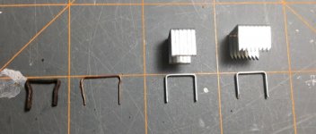

Hello Folks,
I was able to find my wife's staples and have some to show next to the original staple removed, the staple from the reproduction chinscale set. The original "Staples" come in various sizes, and I determined that 3/8 of an inch or 8mm are closest to the original one. The US-made staples are closes to the original All the staples, original, Indian, and the US manufactured stapes are all magnetic. I hope this helps y'all.
Best regards,
Thank you very much for the photos, this message will definitely be useful! Please say hello to your wife.
