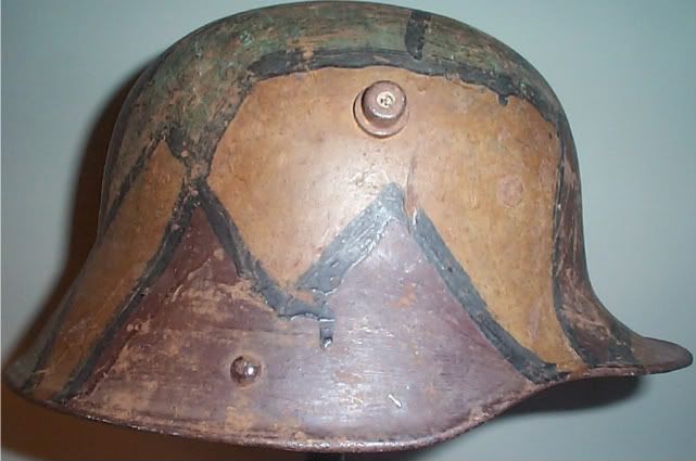

Hello, would anyone with experience let me know if this looks original. The helmet has what I think is ET64 stamped on the inside. It is the camoflage I am wondering about. It has no liner & is missing a rivet in the back. Thanks
I can't be 100% certain going by these pictures, but the camo certainly looks old. I think it's okay.
Hans

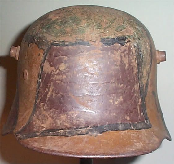

Thanks for taking a look Hans. Seemed to be roughly done, but I guess this wasn't very important, if it was painted in the field. I have added pictures of the other 2 sides.
Hey Don.
This helmet looks good to me in the photos, but haveing your hands on it is more important, The poor quality of the paint job is something that a person making a fake would try to simulate, because many were painted in the field, some of the nice period cammos were probably painted post war for the soldiers to take home.
I like this helmet
Best
gus
Thanks for taking a look Gus. It sounds like it may be ok. I will try to find some one with experience with Geman camo helmets for a hands on look. I took a chance buying it as I had never saw one with that bad of a paint job. appreciate your help
I honestly think MORE of these helmets were painted on the boat ride home than during the war. Same with the American insignia.
The photos from the period just don't show that many camo helmet. That said, this helmet looks to be of the "era." I think we have to accept that a lot of WWI stuff is really WWI era.
