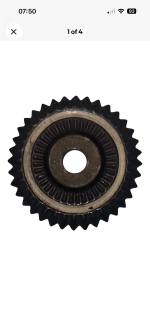

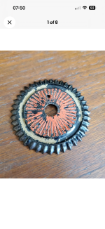

Heres a question you know there are hundreds of cockades on ebay with the small hole and very few with the large hole. Anyone thought about simply drilling out a larger hole on the small hole versions, after all when the chinstrap is on you would not notice. Rob
