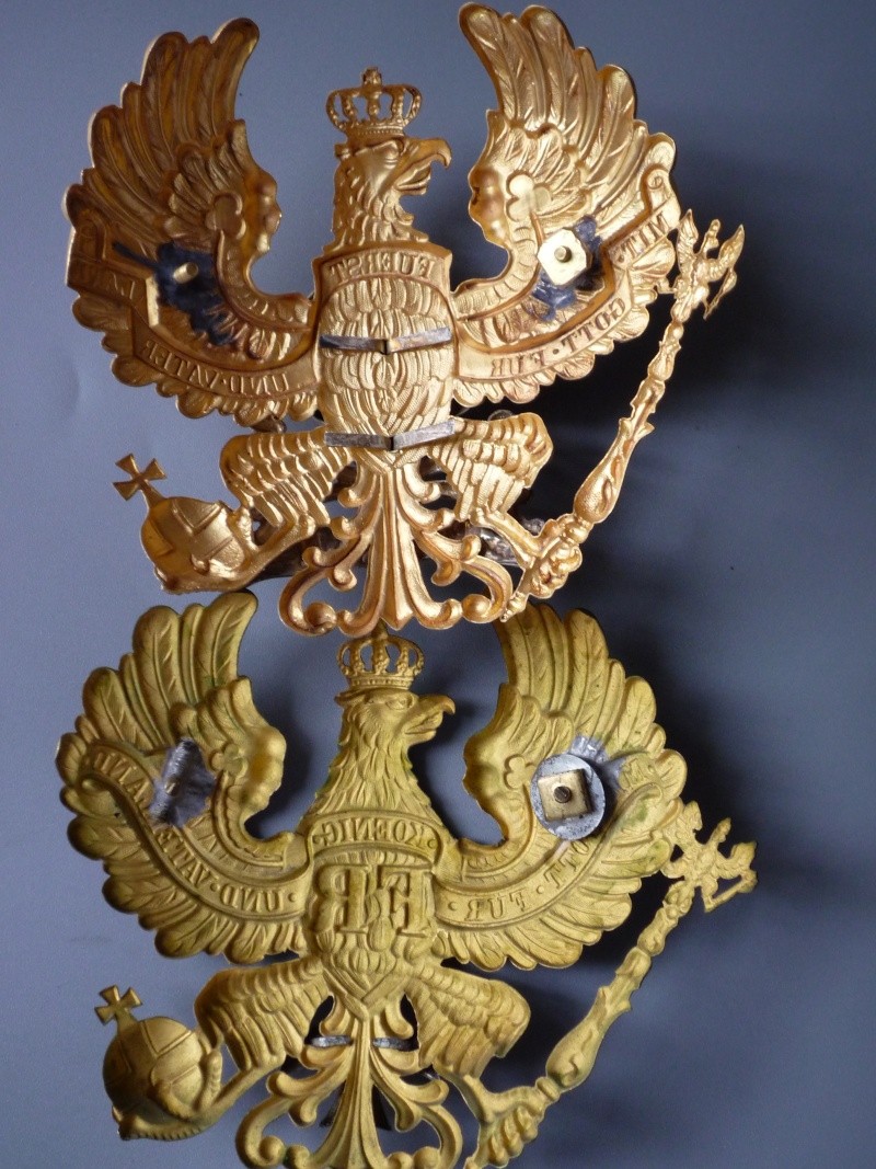

Poor repro if looking at the back
and now better repros:
on the top, repro from Kammerbulle, below a genuine Off plate

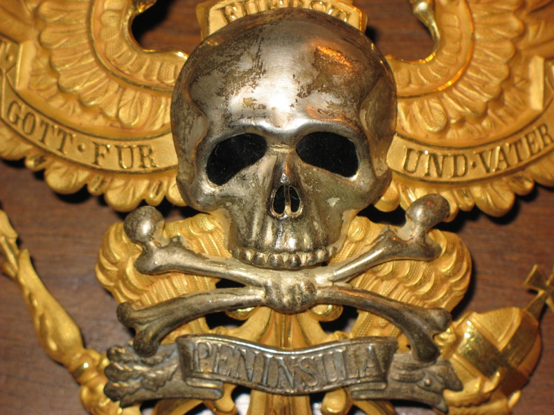

better view of the Kammerbull repro skull:

Merci Eric,
Could you possibly send me the full-size photos of the front and back to my email? The Totenkopf is not the correct shape with poor detial and that is easy to spot, but the eagle Wappen, I am not that I would be able to tell? Is the detail poor on the back? Or....?
And Eric did. And I can see now what Brad was describing; poor detail to the reverse, bubbles, very thick, modern thread on the bolts and nuts etc etc. So, I feel much better now, these things had me very concerned. Thanks Eric and Brad.
