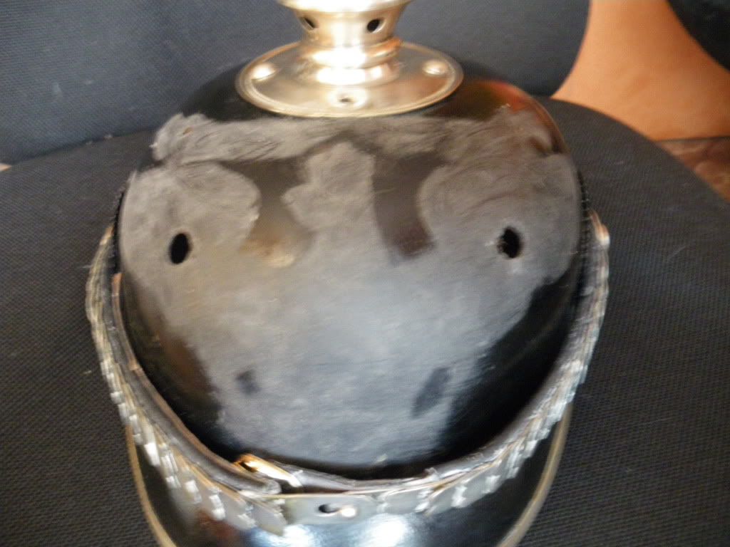

The vendor was quick in sending two more pictures:
regards
Marcel
I must say I am very impressed with this ghost!!! :o Pretty big holes in the shell... :eek:

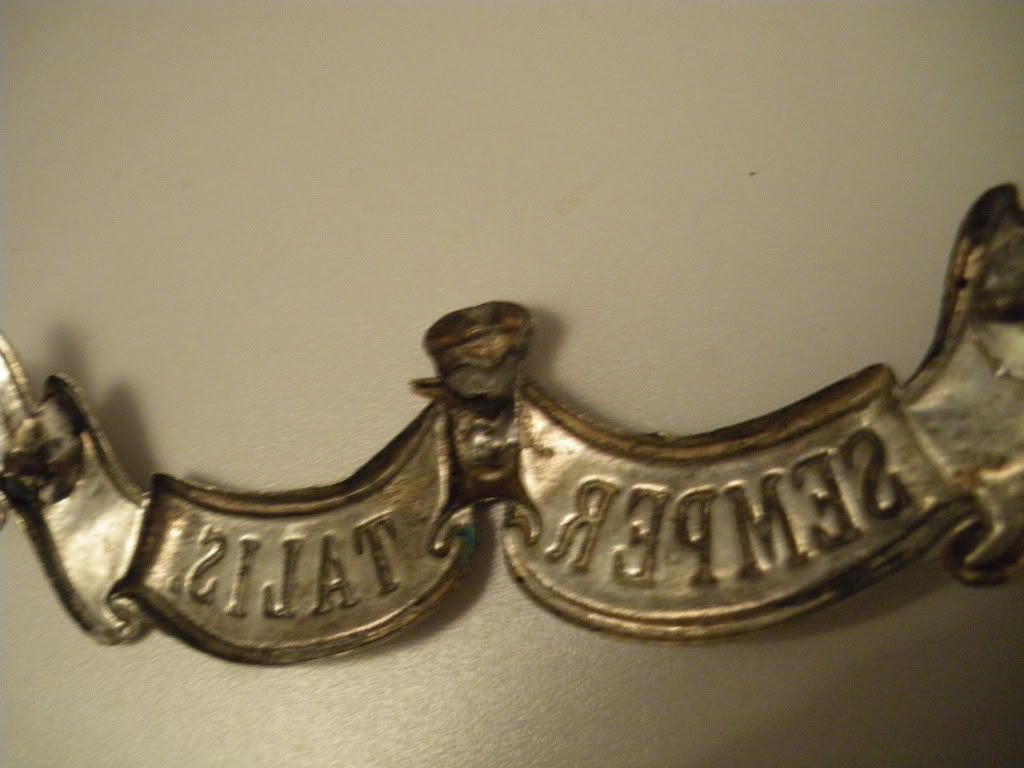

How about the backside of the eagle? I am curious.
This helmet looks too shiny and too clean to me... And I don´t like this combination of M15 liner + wappen with voided crown + chinscales, but no M91 side posts for a leather chinstrap. It makes no sense to me. Just my opinion...
Philippe :salute:
An original and honest one would have earned double money (or even more...)
Philippe :salute:
