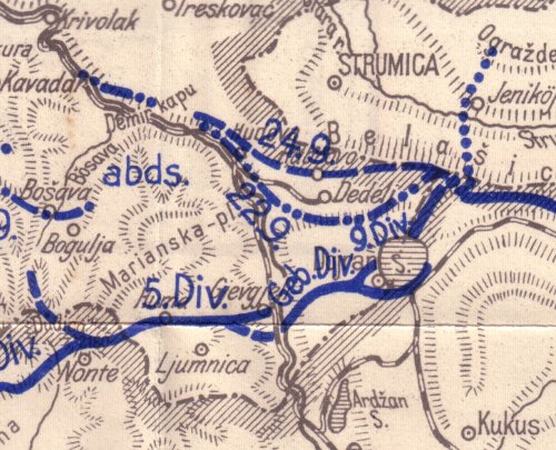

This map should explain a little better what I am looking for. It is a map of the 1915 invasion that shows the areas. the boundary shift and the subordination of the GMGA must have been significantly different a year later. I know Bulgarian units were sometime subordinated at the division level to German units. Did it work the other way around? Is that why there is no trace of unit 203 until now? I don't know.

This map shows the front line in Sept. 1918 before the allied offensive. I believe that the front was quite stable between the end of 1916 and the offensive in 1918. The Bulg. inf. divisions 5 and 9 are positioned at the Belasica. The map is from the 11. Reichsarchive part.
