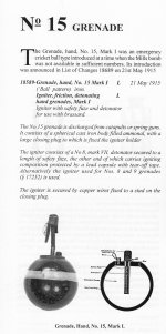

Thanks I really appreciate your help.I was looking at French Grenades but the top is different, it only has one hole. These if you look closely have three holes with a little nib as well. Which is what made me to believe they could be German model 1914 clockwork ball Grenades without the mechanical part.
I'm still looking to identify these so any continued help would really be great. I've also been thinking maybe they could be WWI Russian but I don't collect Russian items so my knowledge is very small on the subject but was able to find this info.
These also seem to have the same configuration with the three holes and a nib with the bigger hole in the center where the fuse would be.
Thanks again John Josef
Thanks Mike, I really appreciate any input. Do you have a view from the top ? Does it have the three hole configuration plus the nib like the ones pictured ?
Looks very similar to the Russian design. Or does the Russian design look like the British one :unsure:
I was told these came from the early battles in the east. Which is just a story and like everyone else here I don't buy or put to much stock in stories. I go by the item and what it says.
Sorry, I don't have a top view picture but I know from handling examples of the No.15 that there were the 3 holes, the outer ones to take a tool to screw the top plug in.
Thanks I appreciate it,
The only things I have that are British are two tunics from WWI. My knowledge on the M15 British hand grenade is very small. I do know they didn't use it very long and they are super rare to find. (y)
It was indeed used only a short period of time because it was unreliable. More often than not they wouldn't explode.

I think these were made to be deactivated war trophies (DEWAT). They came in a large collection and these are the only ones I've had to think about the others were easily identified and most of them were also cut in half.
If you can dig out your 15 and take a photo of the top I would be able to consider these done. I'd appreciate that (y)
