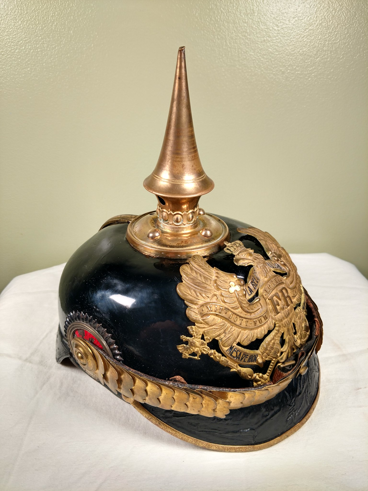

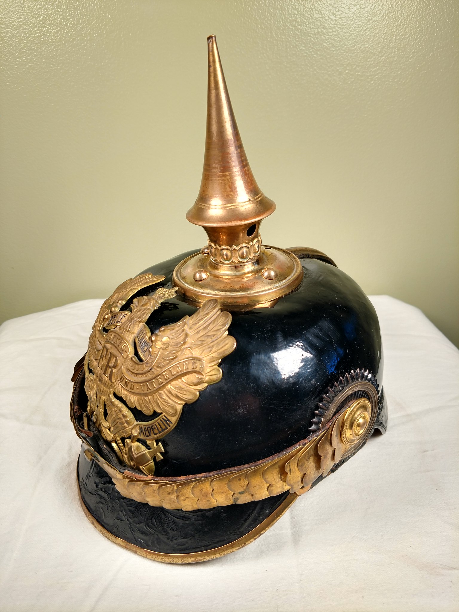

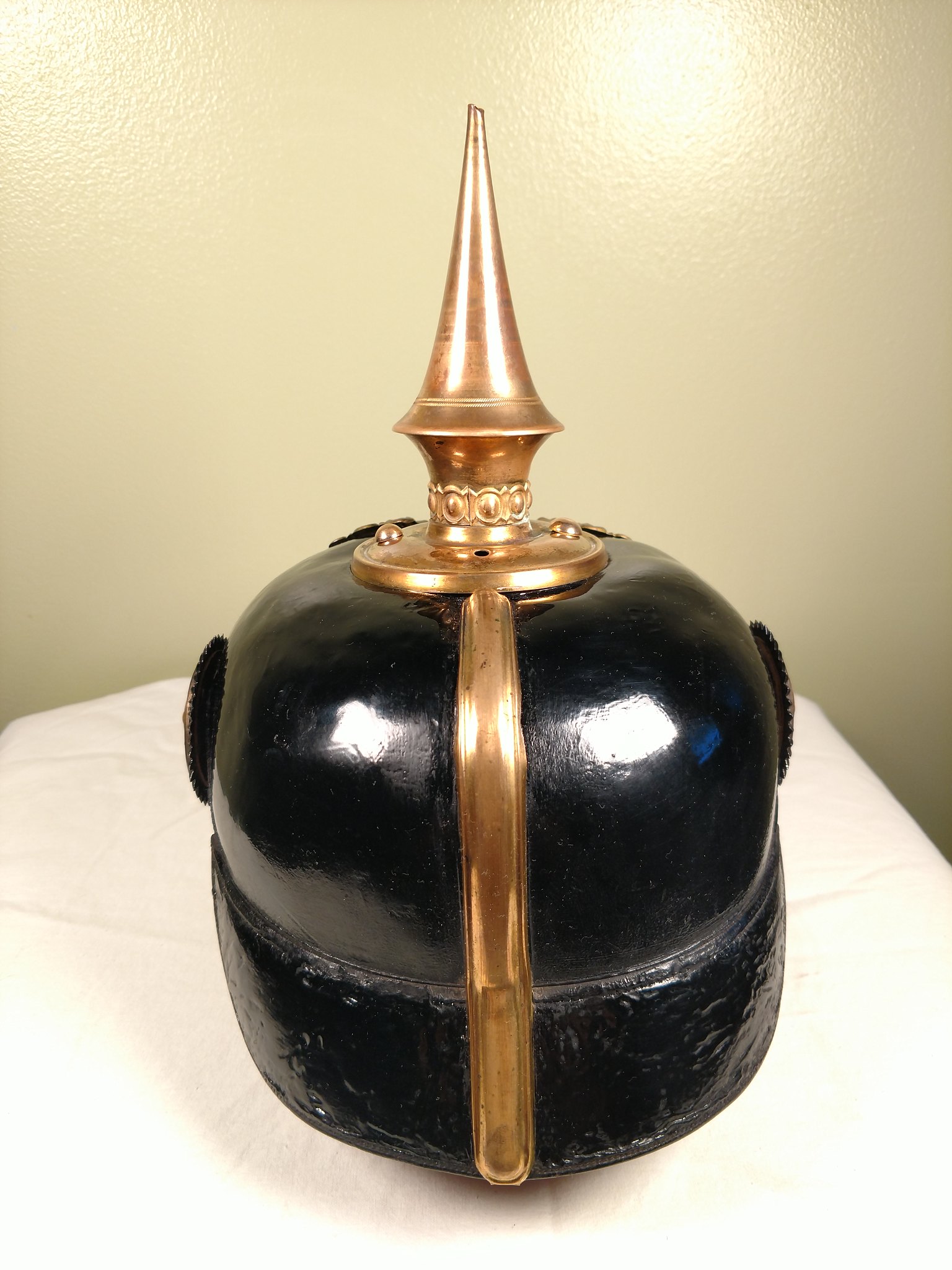

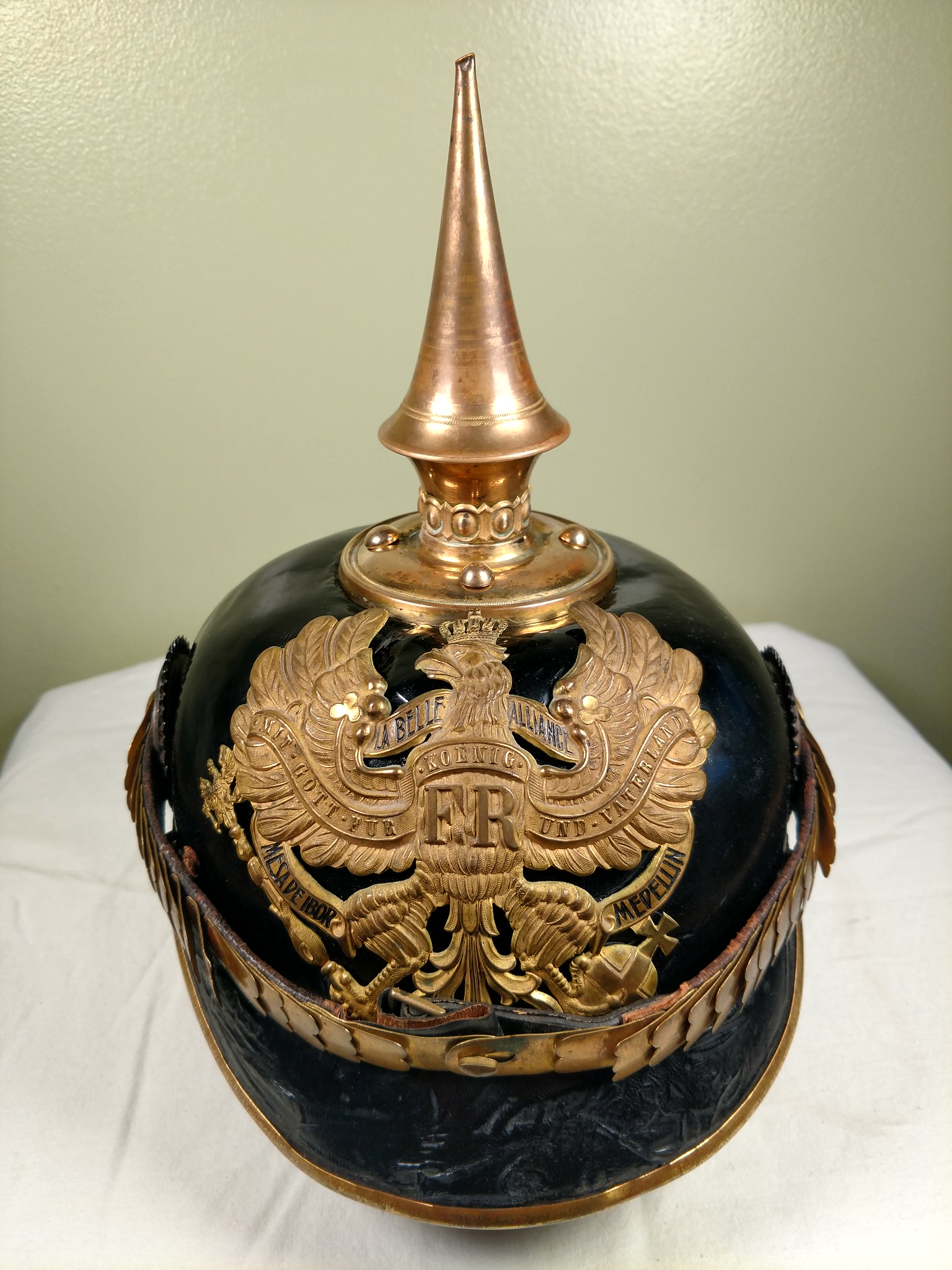

Thanks Steve. So after 4 months of work this is where we are at on this helmet, the end is finally in sight.
The sanded patches are areas which still need a bit of work. The shine will be dulled down so everything matches but this is approximately what new hauben would have looked like finish wise.
The dark areas on the left show where more finish is required. Tony....the wappen was not sent with this helmet but I will ask John the owner to post pics in the wappen section.
Scales and spike back on as is a new original piece of visor trim. This trim from another helmet fit perfectly which is very rare!! 😀The lighting here makes it look like there is a huge dent in the front of the helmet. There is a dent which refused to cooperate with me but it is not huge and most of it will be covered by the wappen when it is put back on.

With my greatest apologies to Brian for taking so long to post these, may I present his unbelievable skills as a craftsman and artist, for which I shall ever be indebted to him!

Brian provided excellent craftsmanship in bringing back you Pickelhaube from the abyss and I see why due to the unique wappen! Is there a specific purpose for using OR rounded spike brads rather than Officer’s star brads for the spike base?
Best regards
John: The OR spike base brads are original to the helmet and I did not have a replacement for the missing screw post brad. As to what constitutes a OYV helmet or even a private purchase of any other ranks helmet, I have no clue. I suspect that each regiment had it's own rules as to what was acceptable for these non government issued helmets. The round spike base brads on this helmet indicate that the owner did not have officer rank.
