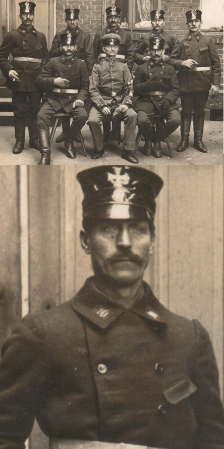

Here's a closer shot of the only pic that I have of a Landsturm guy wearing a Wachstuchmütze. Unfortunatly I can't make out the number on his collar.

Look how shiny these caps were! These one are unusually "perky". Does anyone have one or know someone who has one? I do not know of one in a collection and I have been looking for one for way longer than I want to admit. They are just gone.
Nice view of that odd Landsturm Litewka with single upper pocket too.
