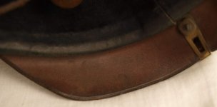

There was still a faint JR74 marking on the rear visor, only to be detected while made wet with care and under angled light, impossible to photograph...
