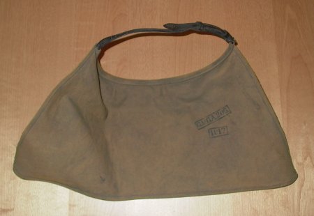

BTW, here is my neckflap. Same stamp as on the helmet.

I like your Nackenshutz I just don't like the markings.
