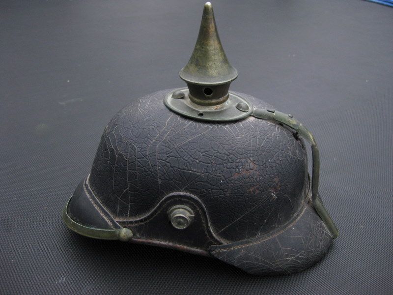

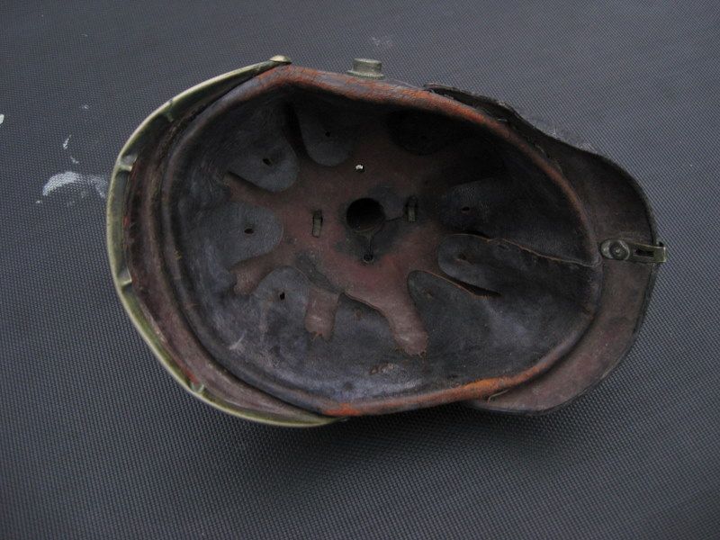

On the underside of the neckguard, I tried removing some of the dust to see if I could locate a stamp or any markings, but to no avail. :( Under the front visor, there appears to be some black markings, but I'm not sure if this is just the discolouring of the leather. The only markings I could find were under the liner on the inside of the helmet shell - in faded handwriting on one side, it says "Jungen" (or could be "Junger") and on the opposite side, it says "K. Jungen" (or "K. Junger").
On the restoration/preservation side, can anyone recommend what I can use on the underside of the leather to nourish it? When I was inspecting the neckguard for distinguishing marks, I found the leather to be very dry and starting to develop cracks.

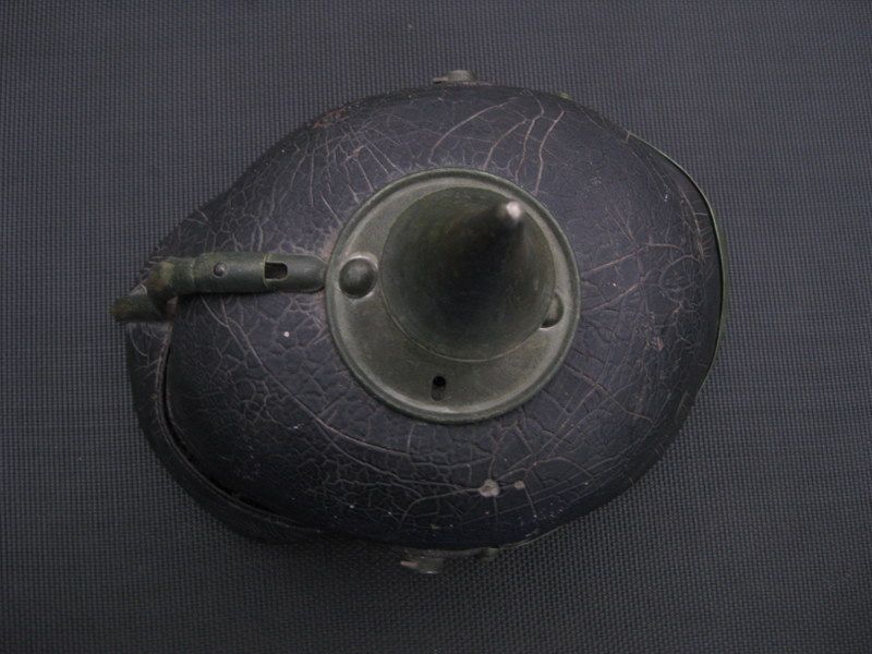

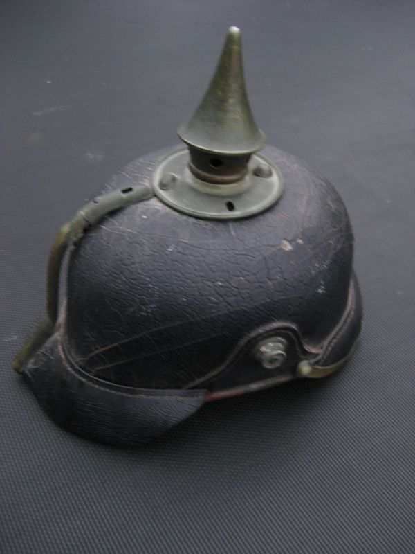

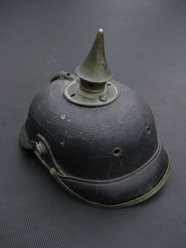

(a) Regarding Brian's method of using sandpaper and shellac thinner - from the photos I have posted, do you think this would work on the helmet I have?
(b) On shellac thinner, can someone please confirm or otherwise my findings: shellac thinner = denatured alcohol = methylated spirits ?
