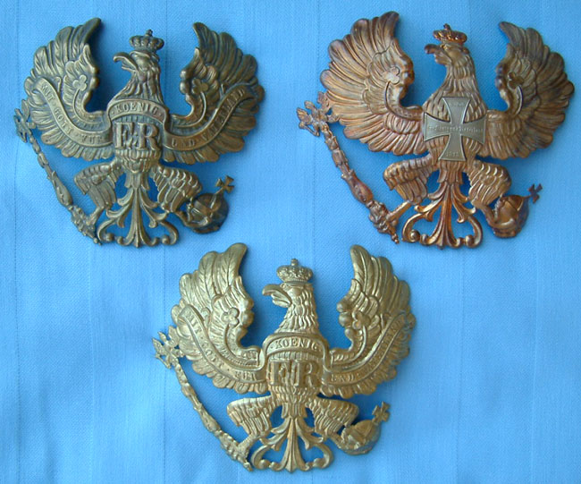

The Preußen issued Wappen in 1895 were supposed to be made out of Tombak as but it seems that this was a poor decision and they were soon replaced with Aluminiumbronze Wappen, which actually looks like a very bright brass. Typically, they do not tone and tarnish like the brass Wappen. Preußen Wappen in the initial 1895 Tombak are not common. I only have one, a Tombak Reserve Wappen. The Tombak is almost copper, like a penny.
The top left is a M91 brass, top right 1895 Tombak and bottom, M95 Aluminiumbronze. Not the best photo I am afraid, but in-hand there is a big difference.
Arg! Click to enlarge the photo. I STILL say 450 pixels is too small!
Great information Tony. I believe the reason Tombak was dropped as a material for front plates probably deals with the material being very soft due to the high copper content. Tombak front plates were likely prone to damage.
