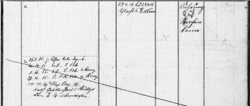

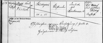

Eugen WERTSCH was in the 1/FR22 and was KIA on the eastern front near Olesza on the 2.7.16. He was burried there, as interestingly documented and drawn in his data sheet in the Kriegsstammrollen (I never saw that before!):
However, I spent a little of my time to look at all the soldiers of the LJR22 (Companies 1-12) whose names begin with the letter W.
So I was able to find a guy called August WERTSCH from Stuttgart, who was at the 9/LJR22. He was mobilized August 1915 in the Landsturm Rekruten Depot 6, then moved October 1915 to the Ersatz-Bataillon JR126 and finally moved on the 27April 1916 to the 9/LJR122. This unit was at this time in the Verdun area. For some not mentioned reason, he only fought two days, as he already moved on the 29.4.16 to a Lazarett in Stuttgart (Katholisches Gesellenhaus). On the 14.10.16 he left this Reserve Lazarett back to the Ersatz-Bataillon of the LJR122 where he seemed to stay till the end of the war...
