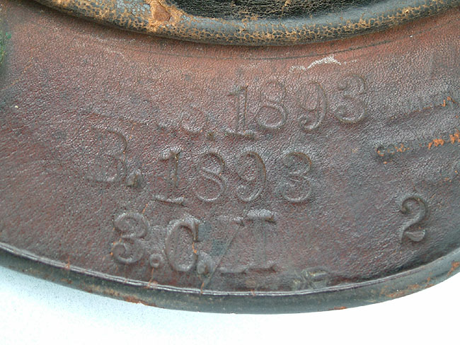

Case 3. The photo below is of the rear visor of a Model 1871 Preußen
Eisenbahn Regt (Railway) Mannschaften Pickelhaube. One of the issue dates
shown is clearly 1893. This helmet hypothetically was replaced in 1891 (if the M1887 was Infantry only), yet
it was issued to a Line Eisenbahn Regt in 1893.

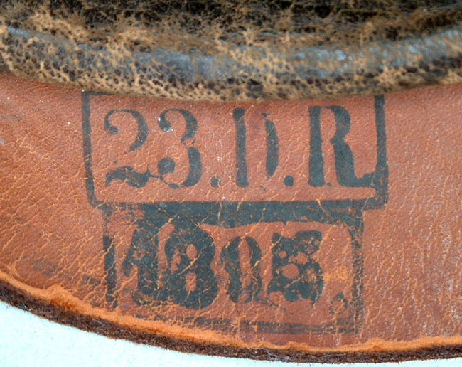

Case 4. The photo below is of the rear visor of a M1867 Hessen
Mannschaften Pickelhaube. Note the unit stamp for Leib-Dragoner-Regt. (1.
Großherzoglich Hessisches) Nr.23. References state that the 1.
Großherzoglich Hessisches Garde Dragoner Regt wore a Pickelhaube with gilt
fittings until it was incorporated in the German Empire order of battle 1871
as Dragoner Regt Nr. 23 and the helmet fittings were changed to silver. The
helmet below, has of course, gilt fittings. Not silver, and it is clearly
marked DR23.
Note also the stamp of 1885. The first two numbers 18 are a
single stamp, the 8 and 5 are stamped on individually, (the 8 was stamped
upside down!) Is this date a later date stamp when the helmet was re-issued
to an infantry Regt and DR23 did receive silver fitted helmets? Or were
Squadrons in DR23 still wearing gilt fittings as late as 1885?
