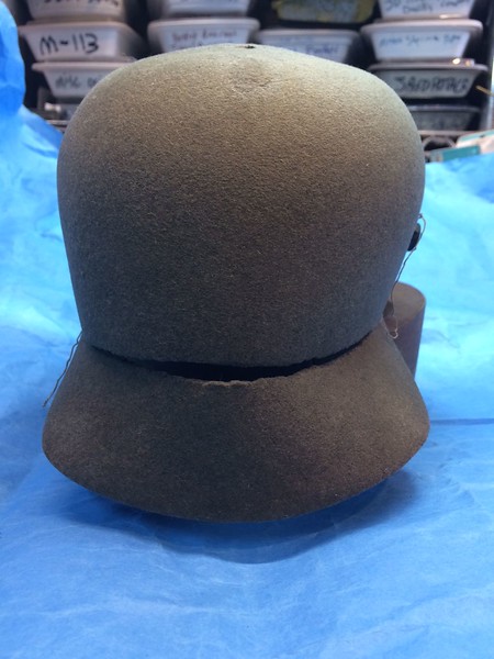

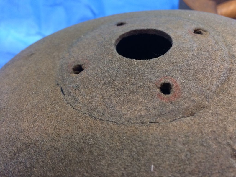

The dome was sunken in and the rear stitch line was torn along with the spike base.

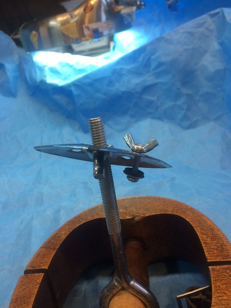

I was able to put the dome back into shape using an antique hat stretcher, a threaded eyelet , spike base,4 thread screws with wingnuts and a repo chinstrap.
I do not have pics of the contraption ( i will post later)but I was able to pop up the dome without having to wet the felt.

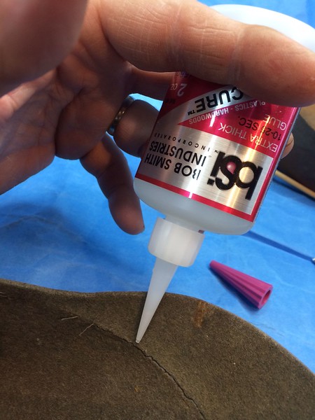

I used my super glue repair method by gluing a little at a time holding the edges tight and hitting it with glue accelerator.

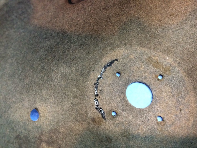

I glued the inside of the tear.
Repaired

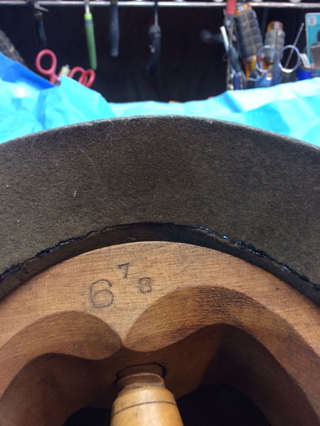

The back tear on the thread line
The shape was deformed so I put the hat stretcher back in to shape it properly.
After I got the shape right I glued the tear .
Repaired
The original out side thread is still there so I want to try and keep it .
I have an idea on how to do this but it will be tricky because I want to sew the liner back in as I do the thread repair.
Hopefully I will able to sew the liner and do the thread repair this way.
1. Using masking tape I will lay out the holes and drill through the hard glue for the thread holes.
2. Push the original outside thread through the drill holes then slide the back up thread through the loops and thread that through the liner holes then repeat .

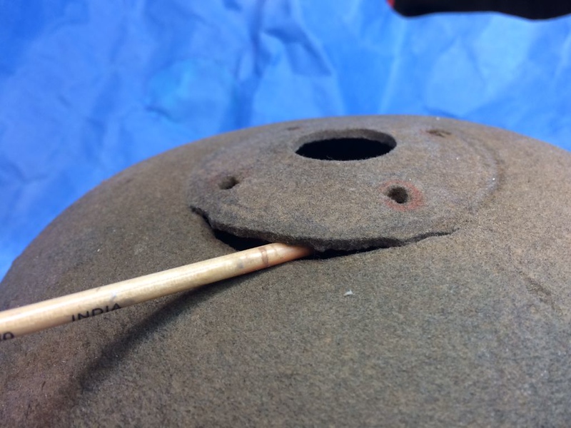

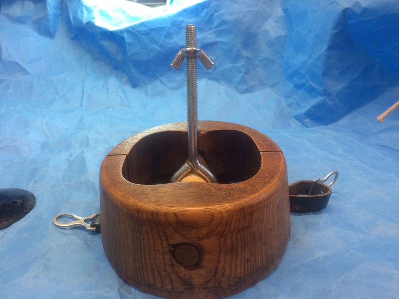

I had it in traction for about 3 months till I was ready to work on the helmet.

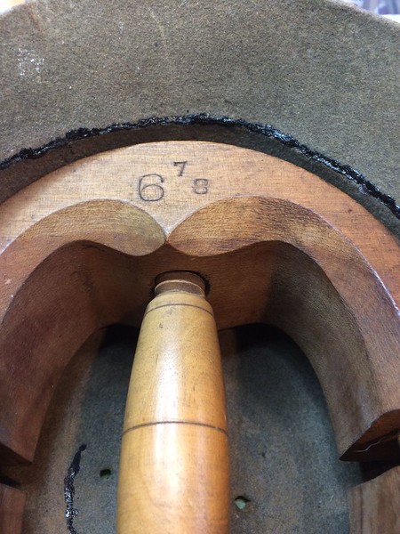

Repaired

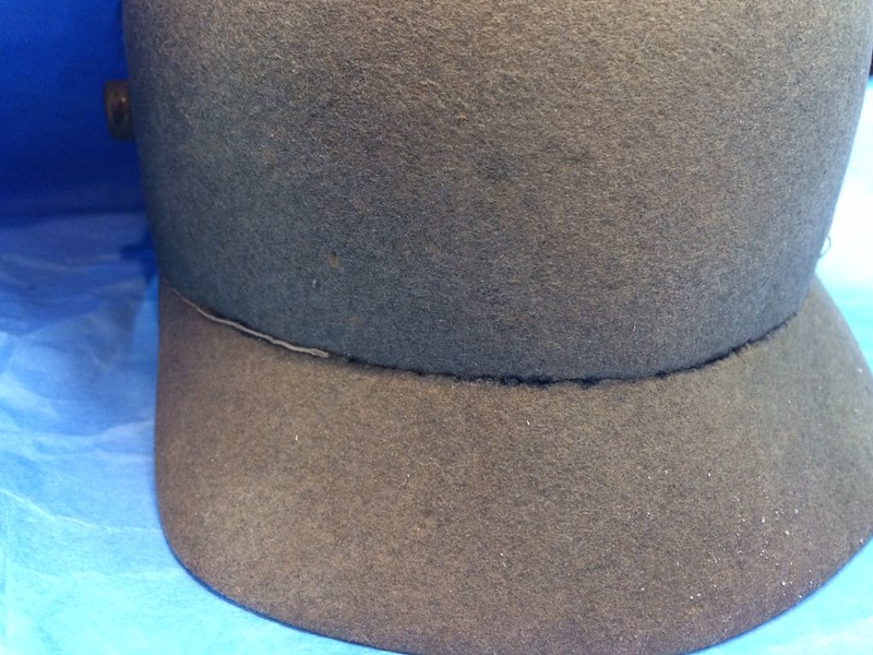

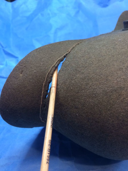

Repaired
I will probably will have to keep the repairing thread loose so that fighting the liner will hopefully be a lot easier.
