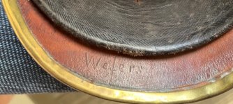

There is also a name on the visor (Wefers?) that is hard to make out and maybe another one inside that is also hard to make out.
