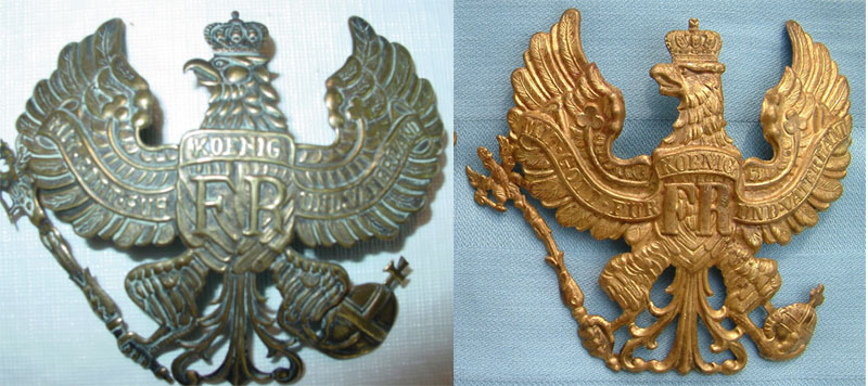

Am I the only one that noticed that the attach loops on the Wappen have been moved?

The shape and appearance of that chicken are just not right for a period original Line Eagle Wappen. The Kinder helmet idea in novel, as those Wappen were "close but no cigar" to actual military ones. Cannot speak for the helmet shell, but that might explain that swollen Wappen. That thing needs to go on Jenny Craig. Compare it to a standard line eagle Wappen below.

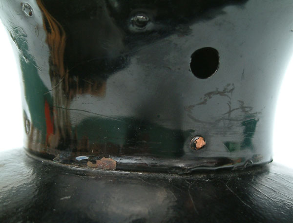

The profile is contoured over the ear with a rolled edge.
The visor is held in place with rivets. The edge is rolled; therefore, brass visor trim was never intended.
The Wappen is brass, as are the Knopf 91. The Preußen line eagle was once gilt, traces of which remain. The eagle is attached using conventional M95 loops and leather wedges. The loops pass through both the tin outer skin and skullcap.
A final view of the construction. The slot for the Feldzeichen measures just one centimeter across. I wouldn't be surprised to learn the original badge was likewise made of tin.
The mortar is static and cannot be removed. The four corners incorporate small underside vent holes. The Fangschnurr toggle is missing, but chipping to the paint surrounding the hole indicates the Tschapka was fitted with cords. Finally, as with the chinstrap for the tin Pickelhaube, the leather is riveted rather than sewn.

No, it appears to be assembled just like an M95 spike/spike base. The neck passes through the hole in the shell and is soldered to the underside. Drat these pixel limits! The side view above provided great detail of the neck before being arbitrarily shrunk to the proportions of a business card. Is anybody listening? The pictures are too small.
Now, for some additional photos I took this morning. The holes at the four corners of the mortar are the only means of ventilation (not counting the slot for the Feldzeichen).
