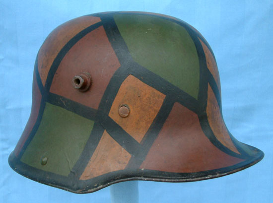

WWI Camo opinions
siquisiri
companeros,
I could really use your expert opinions on this helmet.
thanks
Francisco
Hey Francisco,
Muy bien, looks good to me, the green is a bit bright, but that could be the photo, and the Otto Koch lable has been discussed before.
Gustavo
Francisco,
It is certainly not in the regulation colors. I would not bother me so much if only one were substituted, but with the blue and odd shades of yellow, brown and red, I would pass on it. I would not want to try to have to explain the colors if I decided to sell it in the future. Everything else looks fine.

Hi Francisco,
It looks not good to me ( only the colors ).
OTT
Otto,
We can still read your first post, you are not covering up very well. I am still inclined to say it is good, a fake would do a better job of making it look like all the others. Judging by the off colours and the sloppy painting on the black lines, I think this is a helmet that was painted at the front with available paints. So far all the fakes (only a few) have had very rgular black lines, also (even though it is possible to age paints) the paint looks properly oxidized. That all being said, I would have to admit that Chip has much more knoledge on the subject than I have.

Gus,
It has been my belief that these odd colors were post-war paint jobs, done (for the most part) by those that catered to the battlefield tourist industry in Europe after the war. I know quite well that not all camo helmets complied with the regulations. That is to be expected, but to me, this is not of the period. I agree that the surface is oxidized, but if you study the surface of period painted helmets you would notice that the most common disruption of the surface is created by the paint being chipped or scuffed. This paint looks like it was applied over an already oxidized surface and the rust bubbled up from underneath. The paint looks watery and faded, other characteristics not shared by the period camo helmets that I have seen. Just my observations.
Chip
Good points Chip, but as it was a helmet that would have been a year old when it was repainted (if it is a war time paint) it should have some signs of chipping and rust under the camo. I tend to believe that the standard camos that have the even black lines are the post war souveniers painted by locals for the American soldiers. The reasoning behind my opinion is, I find it hard to believe that there would be so much uniformity in the paint during war time. That is just me talking, but then I drink window cleaner.

These are not the standard colors for camo helmets, however artillery guns crews were issued with about 7-8 different colors for camoflaging the guns. They are much harder to hide and require more elaborate painting. It would be easy for someone to appropriate some of this for their helmet. The regs for painting the camo helmets with the black lines came out in July 1918. Of course there was a lively trade in "trench art"camos after the war. I have one and you would never know it was trench art done if there was not pitting under the paint. The colors are perfect and it has 80 years of age on it.

Dan, they should all have pitting under the camo paint. These helmets were wore in combat from 1916 up to July 1918 when they were ordered painted in the field. The paint was supplied to the units, they were not factory done, which of course you know. So most of these helmets already showed exsessive wear when they were over-painted in camo. But the important thing as you said, is the colors.

I have to back Tony up on his statement that all helmets should have some wear under the camo paint. The story of the Belgians painting the camos may be a myth, but I would bet that they did find out that an unusual helmet would make a better selling souvenir, and one reason that there are so many como helmets could be because the more unusual helmets were saved from the distruction process. If there were millions of field gray helmets and only thousands of camo helmets, one could believe that the camos would be desired for souvenirs. Nearly all the trench art arty shells are post war production, done on order by troops waiting to be shipped home. The dates and locations would be given to the artisan and a selection of motif, depending on the amount the soldier was willing to pay.
