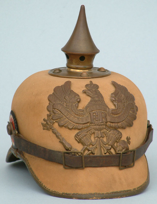

Feldgrau Fall update #1 Ersatz cloth-covered Filzhelm
Tony without Kaiser
These are not common in any condition, but look at the condition! :happy7:
This is not to be confused with one of the 20.000 cork helmets produced by Firma Ludwig Bortfeldt in Bremen by the Preußen War Ministry in October 1914. This is the scarce Ersatz Model 1895 Preußen cloth-covered Filzhelme (felt helmet).

I'm pleased that you guys enjoyed this piece. :sunny: I have to say, it really is a gem; a real a treat to dissect in person. After examination, my friends such as Roy, Chas, Peter, have all commented that it is one of the nicest (and rarest) examples of an Ersatz helmet they have seen.
I suspect that this pattern of Ersatz Pickelhaube, with the sewn edging, (probably observed in a museum somewhere) was the "inspiration" for the many replica felt Tschakos and Tschapkas with the sewn leather edging that some enterprising jerk made a few years back which occasionally surface like a bad penny.

Rob sent me a picture which I finally got to. I love Tony's helmet, but Rob's questions made me dig deeper. The more I learn the more I realize I do not know. In the ersatz world. I now believe that the words cloth covered helmets provides a better descriptor for a division than Kraus used when he said Korkhelmes. Tony shows an example of a cloth covered felt helmet. On his excellent web site, he commented that cork helmets were cloth covered inside and out with no trim. This was different from what I thought so I looked. The can of worms opened up.
This example from the Trawnik collection is cloth covered both in and out and has no trim.
It has an odd chin strap and a rosette.
This next example is cloth over cork. This time, there are two different types of trim and no cloth cover on the inside.
This next example is cloth over fiber.
It has no spine unlike the one above.
So Rob. I don't even know what yours is made of! It appears as though the spike has been removed. The support ring placed on the wrong side of the helmet and some sort of green backing placed in of the the top of the helmet.
I am not certain that is a bullet hole in the visor. Many helmets were nailed onto a wall. Perhaps it is a nail hole? Cloth covered helmets are not common. They never appear in the shape of Tony's helmet. It just goes to show how everyone should ask questions, because it might just be a reason for someone to do some research
One thing to note Joe, is that cork helmets have separately sewn visors like a standard Pickelhaube. Cloth covered felt helmets, like any Ersatz felt helmet, are made from one piece.
The center one is very interesting, first time I have seen a metal visor on one of those, or a rear Ersatz leather trim on the back visor. It almost looks like a cloth covered felt helmet that has been repaired with two visors? The one you describe as "cloth over fiber" looks to be cloth covered felt like mine.
