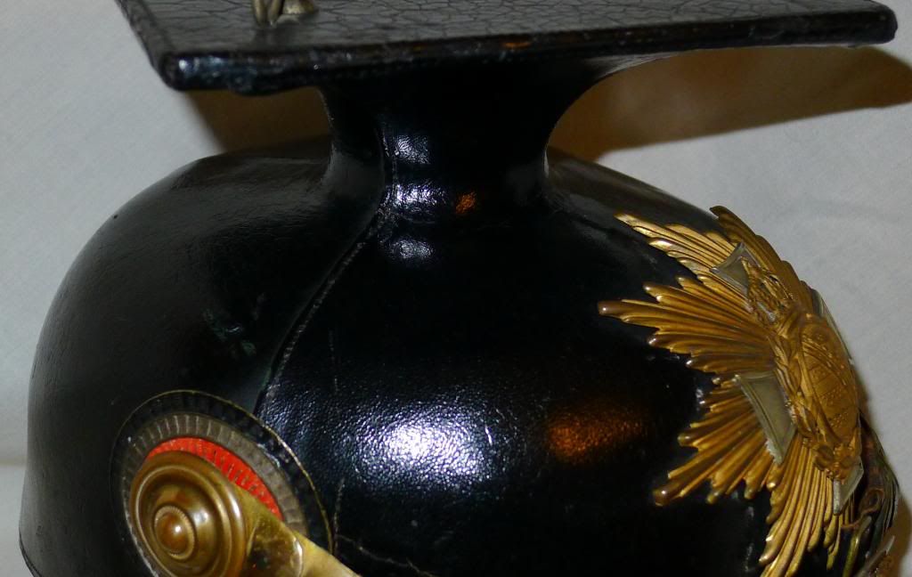

Yes, restoration for a fellow collector. Most of my business comes up from the US. I have another officer tschapka which arrived last week. This one has dents and missing finish in those areas but not as bad as the first one shown here. I was unaware of this fact as I have not handled many officer tschapkas.....they are stitched together at the front behind the wappen. The lacquer then covers the stitches as does the wappen, just the opposite to infantry officer helmets which are stitched up the back. A thin strip of leather is glued on the inside to hide the seam. Learn something new every day! Both these helmes have this arrangement so I am assuming the same method for all officers tschapkas. OR tschapkas like pickelhauben are made in one piece...no seam. I believe this was done on officer helmets to lighten them.....a conjecture on my part.

Brian, some officer Tschapkas shells are also made of four quarters stitched together, like a football. D. Laine told me once that these were higher-quality, more expensive Tschapkas.
Bruno
I believe 'stitching thinner leather to make a lighter shell' is absolutely correct. I noticed that the vulcan fiber officer shells are also very light in weight, but probably didn't 'breath' or have the same '(quality?) feel' as leather helmets.
