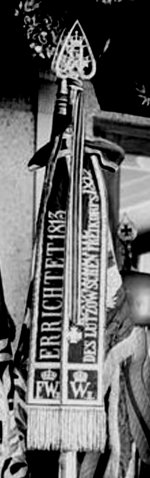

I have the Sakular Parade Banners for the KAGGR # 1 / I Batl and II Batl

Hi KAGGR # 1, thank you so much for showing these tapes. I admire your collection especially with regard to flags.
Yes, the Leib Husaren regiment tape is from my collection. I also have the one from the Kürassier -Regiments Königin -Pommern- Nr 2, and another that I have not identified but that I think
It may be from ULANEN REGIMENT N 6, because it is the only one I have seen that has the upper part of the number 3 in the figure straight
The Banner that I present above can only be from one of Leib Husaren's two regiments
As for the Centennial Band, there were several regiments that had been founded in 1941 but only the two Leib-husaren regiments received their distinction in 1841, the date that appears after the initials of FW IV. (by AKO of 04/29/1941)
The other units with the inscription "ERRICHTET 1741"
Pi.Batls.3 Granted by AKO of 01/08/1876 for what behind the F.II. The date was 1876.
Hus.Rgt. 4 Granted by AKO of 01/24/1895 for which behind the F.II. the date was 1895

Great information provided by all, Steve, Tony and now 03 have greatly expanded my knowledge in this facet of Imperial German military collecting.
