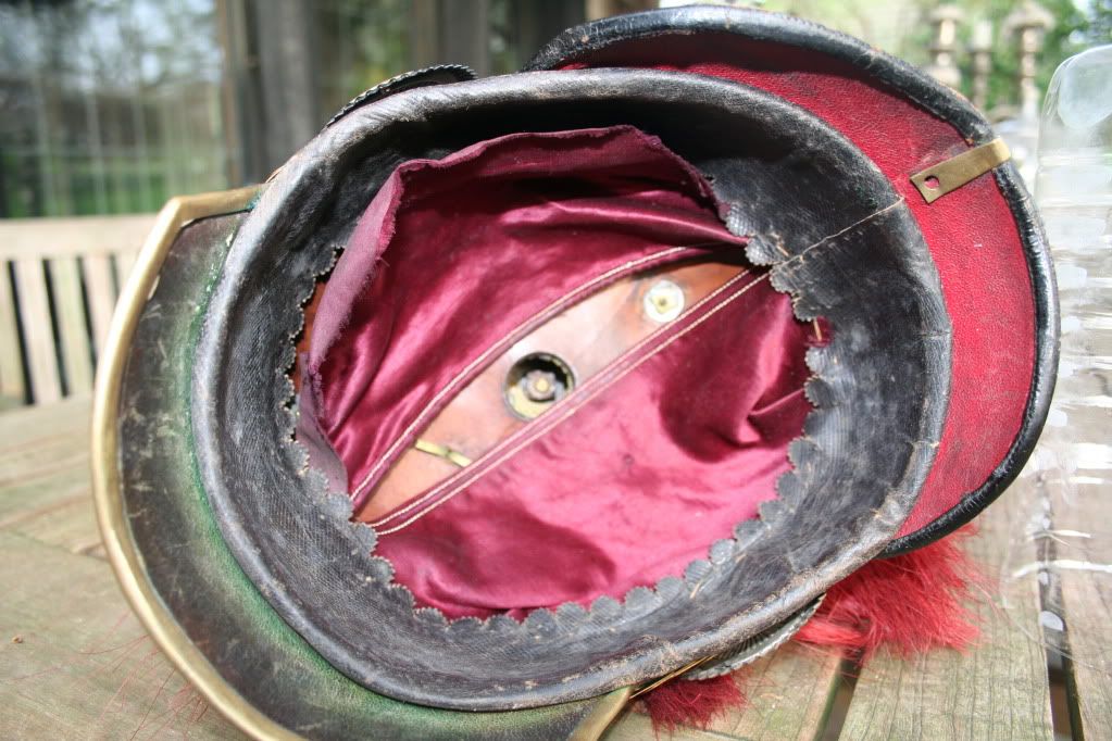

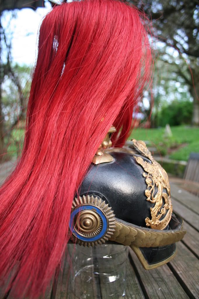

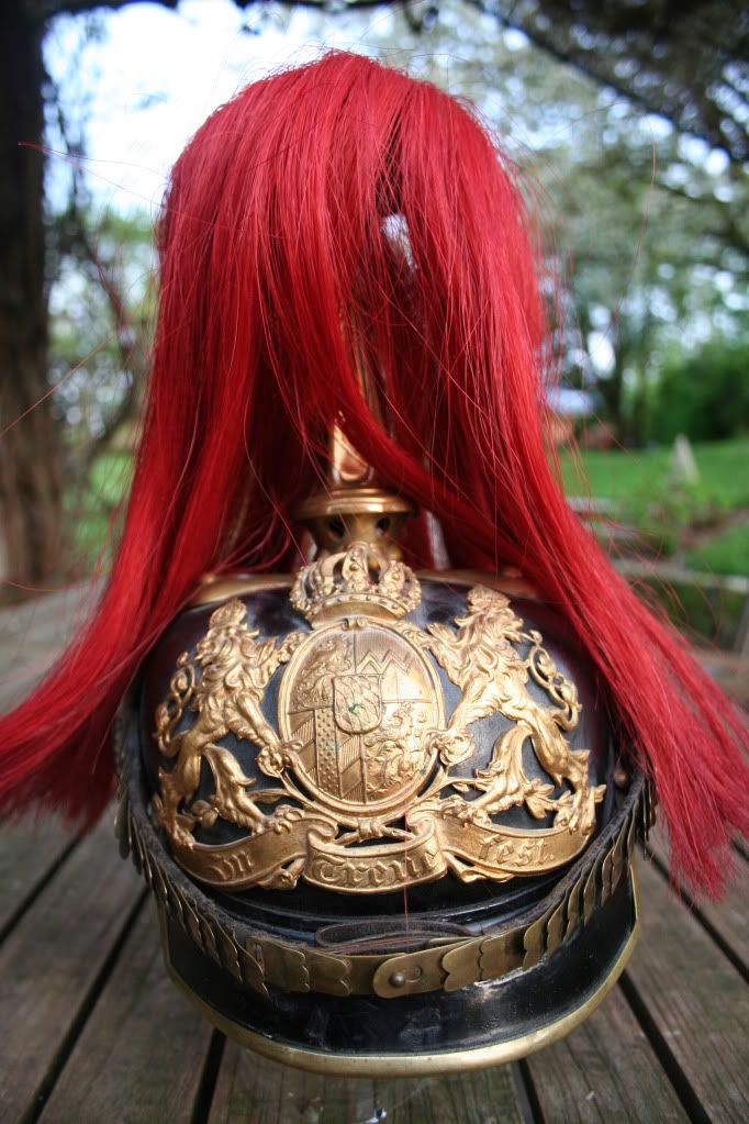

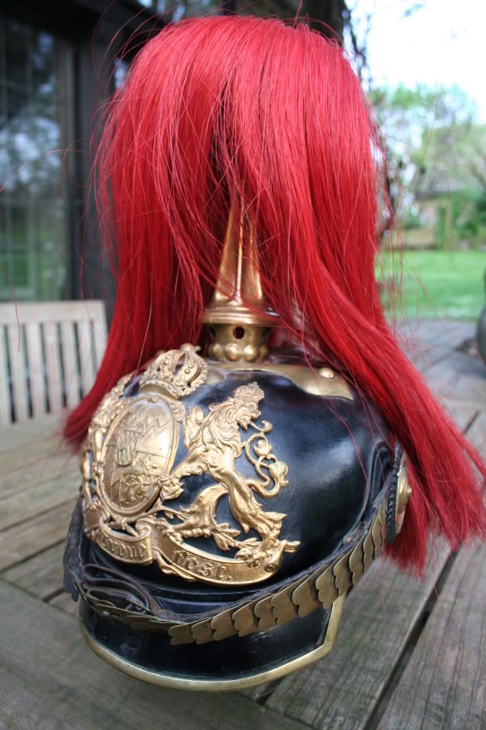

I received my latest find today, and wanted to share it with you at once, it hasn't been cleaned at all!
It's an officer's helmet with an absolutely lovely helmet plate with the laurel wreath. As the parade spike is red, I assume it can only be an artillery officer (am I correct in this?). The kokades are original, only mounted on the wrong sides, but that can be easily adjusted. The leather is in fine condition, as is the shape of the Haube. The silk cloth has an unusual bordeaux red color, but appears to belong to this helmet.. Sofar I haven't discovered any stamps or marks of the maker of owner.
I've bought it from the same guy that sold me the Sachsen Helmet (see other thread, it's nice to see that the discussion on the serrated kokades continues..), and it came with some spare parts, amongst which a fluted spike I have been searching for the Chevauleger Helmet!
I look forward to your professional comments!

Actually Marcel, no. That is not an officer's Pickelhaube. That is a standard Foot artillery Eigetumsstück (privately purchased) Mannschaften (Other Ranks) Pickelhaube for men with the post- 1914 Wappen. Unfortunately, they did not wear a parade plume. Period. So you have to decide if this is a Foot artillery with an incorrect red plume, or a Field Artillery with replaced flat chinscales and Kokarden. The Kokarden are officer pattern and incorrectly mounted on top of the chinscales, so that could be a clue.

It's the perlring, the plain non-ridged spike-base, stud's in place of stars securing the cross-base etc.
Compare it to Joe's example above.

That would be correct. So that takes you back to my suggestion of Tue Apr 27, 2010 5:44 pm that this is either a:
1. Bayern Feldartillerie (Field Artillery) Eigetumsstück (privately purchased) Pickelhaube for men with replaced flat chinscales; or
2. Bayern Fußartillerie (Foot Artillery) with an incorrect red plume.
And finally are the chinscales original to the helmet which would make him a Fähnrich (Officer-Candidate NCO). Regardless, they are incorrectly mounted on top of the chinscales.
