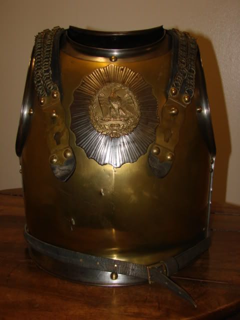

Bruno!
Very cool! That appears to be (correct me if I am wrong) the model 1825 cuirass. Same unit, but mine needs to be cleaned up pretty badly. The one I have is the Model 1855, with the slimmer waist. Not quite as pot bellied as the picture of yours, but a better piece when you think about it. Yours possibly saw service during the Crimean War and would have still been in full use during the Franco-Prussian War as well. Photographs show that these earlier cuirasses were being worn with the newer models throughout the life of the individual cavalry formations. What is the date and manufacturer on your cuirass? Do you have a carabineer helmet to go with it?
