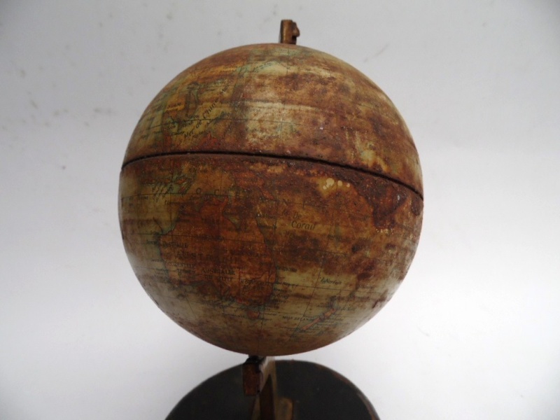

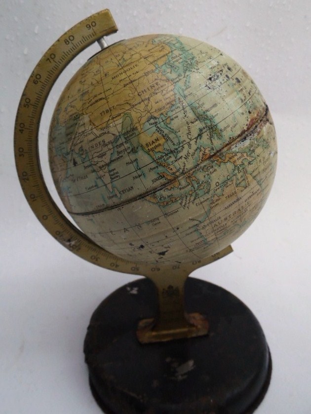

So allow me to show you it does work pretty well.
I was lucky to find the dealer for europe living not that far from me and got my self the smallest container.
Check the result on a old tin globe that wasn't treated so nicely when stored for the last "x" years...
cheers
|<ris
Great result ! :thumb up:

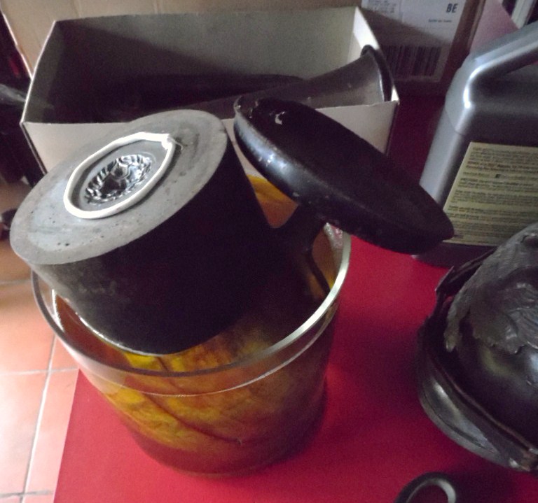

The front and back halves have to be completely sunken in an "evapo rust" bath I guess....
So...I might need a Jerry-Can of the stuff :eek:

The spray comes in a 250ml container. 5 €
The evapo rust comes in 1 L or 3.8 L (one US gallon). 45 €/gallon
Question: can the evapo rust be used again.
One never knows: perhaps a fellow collector who has another messy Kurass ?? :D
Francis
I have used it again with decent results. The efficacy decreases each time you reuse it though
Keith
The company web site states that it can be used repeatedly. Which store in the US carries this product? I am going to the SOS, hopefully I can pick up some while I am there.
