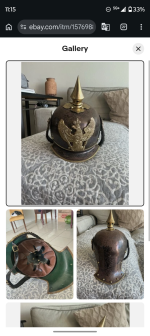

Here is a typical fake helmet probably made in India, these are all over Ebay:
This fake is supposedly representing a Famous Garde Dragoon Regt. Haube. First the "chemical aging" of the brass screams reproduction! Real oxidization of brass is uniform, not in chemical patches! Perhaps the worst part of this repro is the helmet plate/wappen. Again chemically aged and we see an extreme lack of crisp details. This is no where near the quality of the originals. Further clues...the spike shape is not correct, the chin scales ends have no locking fasteners and the small leather strap is obviously newly made and dyed on both sides. Period leather is only dyed on one side, modern, both sides. I am sure that others here will post more clues but this will get us started.

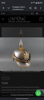

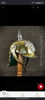

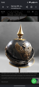

I mentioned this in other threads as well. The Depeeka fakes made in India are by far the most prevalent I have seen. The JzP and cuirassier helmets are almost identical in construction, size and shape of originals. Most times there are real parts added but many I see just replace the wappen. The scales are well made but thinner and flatter than proper cavalry width. The easiest way to tell on the cuirassier helmet is the spike base. It has a pronounced bump where the shaft meets the plate. I have seen both silver and gold spikes on the KR6 brass helmet depending when it was manufactured. Also the chin strap posts aren't quite perfect. The liner is even made the proper way, the helmet below was sold as real, complete with fake liner.
Unfortunately when googling "kurassier helmet" this fake from a renowned militaria dealer is the first to appear. Here's some pics.
