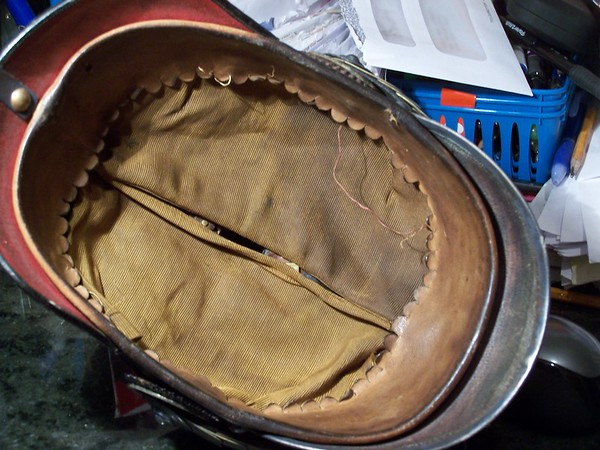

Both visors on this helmet are vulcan fibre while the shell is leather. As usual, all old thread is cleaned out and the visor pinned into place being careful that all holes are lined up. This turned into an easy stitch :) .
The liner on this piece is excellent and I do not believe the helmet was actually worn much if at all.

Thanks to all, I should have had this done years ago as it was a very basic repair that was finished in about 2 hrs. Sandy, all stitching must be done by hand as the machine would crack the old shellac finish. Years ago I tried to get a local shoe repair guy to do a visor.....it broke the needle on his machine and left a line of missing finish along the stitch line. He did not have the correct style of machine which was used originally on these helmets. If you pull up the liner on an OR helmet you can sometimes see a row of marks pressed into the shell caused by the "foot" of the machine. Probably the same kind of machine is used to stitch modern caps.
Many years ago I asked a cobbler (who was also a collector) about restitching visors. He explained that unless you have the same type of machine that was original used it would more than likely result in damaging the helmet. If the timing on the needle was different it wouldn't aline with the old holes.

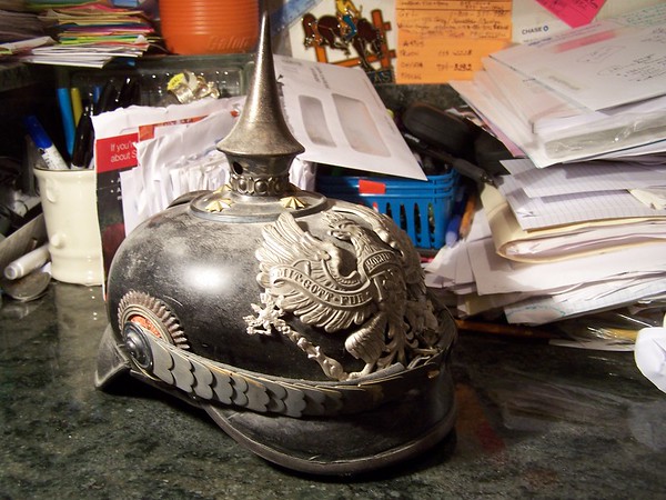

I reassembled this haube yesterday so here are the "finished" pictures:

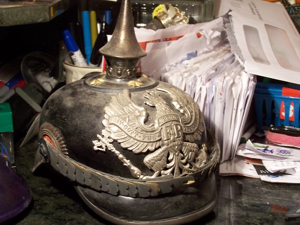

I mentioned that this was a mid war production helmet and the most glaring evidence of this are the zinc pot metal scales that it came with. Fortunately, the wappen is pre war quality, as is the kugel. A mixture of brass and zinc parts is a characteristic of this type of helmet production. On this piece I believe the rear spine and visor trim are zinc but have retained their gold wash. Here are some other characteristics that this helmet has which I feel represent mid war manufacture.....zinc square nuts, split brad officer stars, with washers but no support disc. The wappen here has screw posts but other wartime wappen will have soldered brads on the reverse side. We have also seen here the unusual use of officer M91 kokarden.
The chin scale bosses are brass.

The wappen was cleaned once with a soft tooth brush water and Hagerty Silver Foam. One coat of black shoe polish was applied to the shell and the rear visor was restitched. The helmet is in excellent condition but I may replace those chin scales.
Its a mid war helmet so i wouldend bother that mutch for replacing the chinscales
This was not uncommon on those helmets
It kinda has something a officer with a mixture of diffrent parts
Jonas
I agree with kaiser, the scales are part of the history of this helmet. The piece looks great the way it is.
