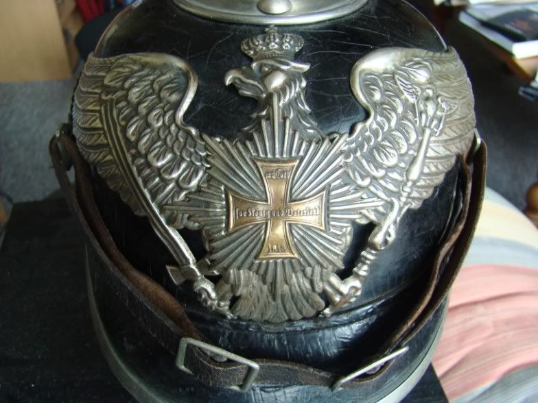

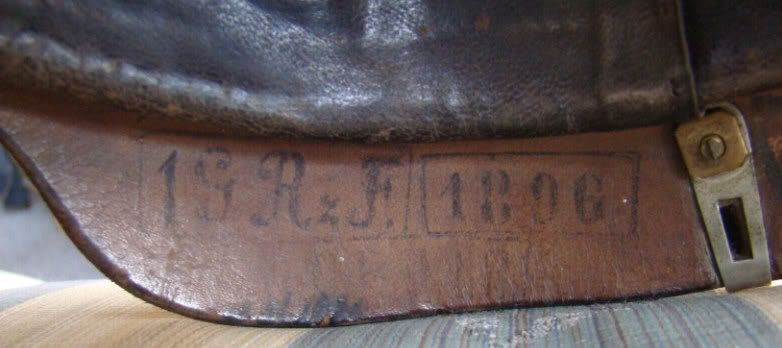

Two weeks ago I bought on an large european militaria auction this Pickelhaube. It is marked with 1.G.R.z.F. 1st Garde regiment zu Fuss.
Since these two weeks I am looking on the internet for information. This is why I found this forum.
As far as I know is this an enlisted men's pickelhaube. Garde ersatz or landwehr. Is there a difference?

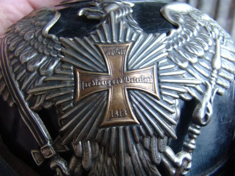

The eagle, the point and the star are made in white metal. Does it mean that it is from a pioneer?
The cross is beatiful sunken in the star.
Can someone tell me more about my helmet.

What you have is a beautiful 1. Garde-Landwehr-Regiment zu Fuß other ranks helmet. This regiment wore silver Beschläge on their Pickelhauben and Mitres. 1.G.R.z.F. was an infantry regiment.
The Reserve troops helmet would feature the standard Garde Star with a smaller cross in gold. As an example, this is an reserve officer helmet for Garde-Füsilier-Regiment/5. Garde-Regiment zu Fuß

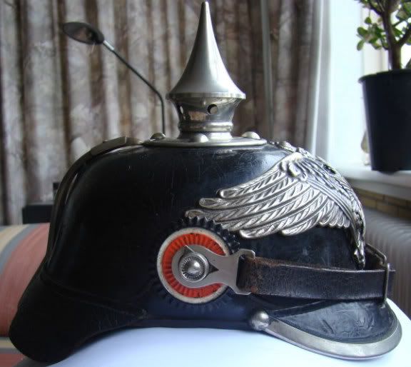

Im new here and I know im responding to a super old post here but I couldn't find much info on a helmet that i just got til' i found your pics. looks like i have a similar helmet but mine has a ribbon on the eagle. its hard finding clear information on this style of helmet. thanks for posting it in the first place!!!
Wow! - another nice one of these babies! Very COOL!!

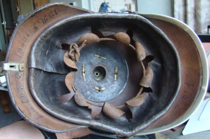

Is it marked inside with stamps of any kind - interior shots please!
Technically as it's Reserve/Landwhere it should not have the ribbon/bandeau but they did not always adhere to this, especially in the case of Officers. I might be wrong on this but.......it's a nice piece anyway - don't clean it too much if at all!
Welcome to the forum! Lots and lots of research here. Mikey asked the important question about the interior. I have an officer one of these but the enlisted version leaves a whole lot of questions. Love to see more pictures of any markings and how the helmet plate is attached. I have a good picture of this in use on the way and will post it when it arrives.
A word of caution about enlisted helmets. Often you will be advised that these are Landwehr helmets. While that could be true it is more likely to be a reserve helmet. Similar to line Prussian helmets there was no specific reserve helmet for the Guard Corps. Therefore, it seems as though the eagle wappen shown above was used in its enlisted form for both reserve units and Landwehr units. This creates even more confusion because guard units of the Landwehr never deployed. As some collectors know the reserve regiments were supplied directly by the active regiment that supported them. Landwehr units came from the Bezirkskomando. The active regiment was supposed to provide a certain number of helmets for the reserve unit. I do not yet know how many. Nor do I know if it was actually done. It seems as in some cases, it was. For the guard regiments there seems to be strong evidence that the Guard Field Artillery and 1GRzF certainly kept stockpiles for reserve units in the form of enlisted helmets with Guard Landwehr wappen. Helmets with Landwehr wappen are known to have had both active and reserve Kammer marks at the same time (left below). Therefore the key item for absolute identification will be a mark for a second unit. Were these used for Übungen prior to the war? Yes! The group below with the Landwehr wappen is a reserve group, dated October 1911.
Hi Weird..welcome to the forum. I saw this helmet up for sale on Ebay....very nice and congratulations. I have not seen more than 3 of these for sale in my 15+ years of collecting. As was mentioned, technically there shold be no motto on the bird becase this is present on the cross. However, if there is one hard and fast rule about the German army from this period, it is that they were very practical and salvaged/reused whenever possible so not to worry. Why worry about changing an entire bird when you can take off the old Garde star and stick on a reservist one?

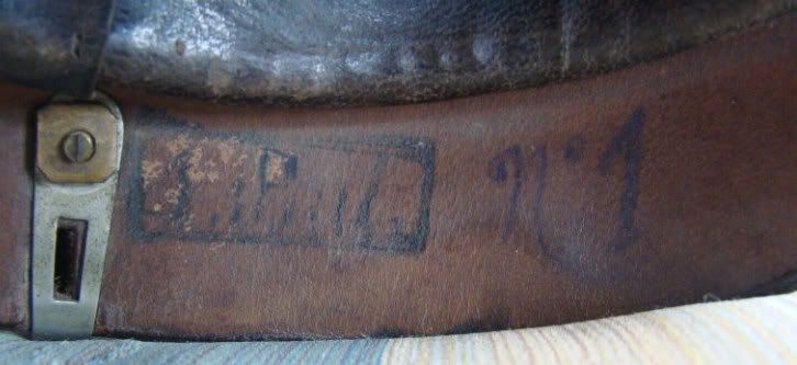

first pic is very hard to read but i think i figured it out, it reads "B.A. VIII 1914" which i found is Armee-Korps (Coblenz).
this pic is a shot of the inside which reads "helm Becker & Co" and "Elberfeld" with "1914" on the bottom and "55" for the size.
last pic is a shot of the inside of the helmet
Thanks for posting the markings -- that is not the BA I would suspect. That helmet is no doubt original and well marked but something is screwy between the Wappen and that Mark.
The picture I posted has a date of 1908. There is nothing on the back. Apparently these guys existed Full-time in peacetime or at least part-time Which was different than the other corps, but I don't know any of the details -- maybe Glenn does. They never did deploy.
