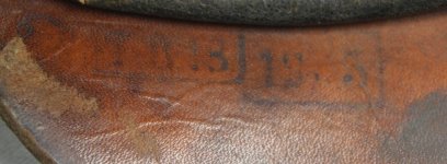

A complete liner and excellent markings; 2nd kompanie TB 18 1900 and then TB 18 again. The size 58cm is faint but can be seen. The helmet was accepted into Batt. stores in 1900. These markings clearly demonstrate why they needed to be removed or blacked out as the war progressed. They give away too much information if picked up by the enemy. This photo also shows us the typical large tin support disc found on Hessen helmets. The use of screw post spike brads is unusual for a M95 helmet. There is also a clear manufacturer stamp inside the helmet: Loh Sohne Berlin. The name Krug is penciled on the inside of the shell.
Hi Brian,
The unit stamp on the left ist not TB18 but TB25. As Larcade wrote, the hessian TB25 was formed 1890.
In the year 1899, the XVIII Armee Korps was created and TB25 joined it. On the 26.03.1901, the TB25 was renamed TB18.
As this helmet is a 1900 one, all is perfect here (y)
Philippe
Thank you Philippe, on closer look I believe that you are correct. The 25 is very faint but this would make sense.
