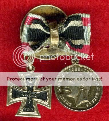

While not pickelhaube related here is a little Prussion/Hessian piece.
It is a miniature award (for civilian dress) that shows the Prussion
Iron cross 2nd class and the Hessian bravery medal in silver. The
Hessian equilivant to the IC2.
