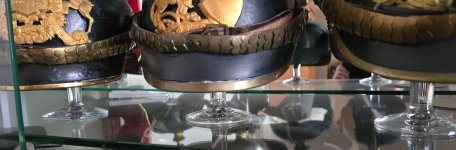

Here I hold my pickelhaube underneath with a beer glass (Duvel glass)Belgian beer:LOL:

I use beer glasses-Trappist. Never foam heads. And an ugly stand can be camouflaged.
Natural-unbleached thick cotton layers between the [sharp] edge of the glass and the liner.

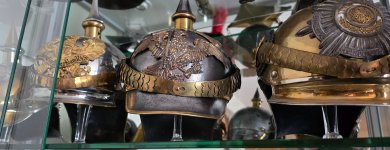

I also use glasses for displaying my helmets. The nice thing about them, is they are fairly invisible, and, also you can find them in different height sizes. Find the right size, so the visors are about 3cm from the place where you put them for display. It makes them seemingly "floating on air".

It also prevents the stitching of the visors from stress, so the stitching is safe too. No more loose visors.
