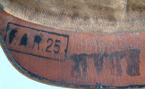

I had mixed results. Below is a M1915 Model 1915 Hessen
Field Artillery Regt 25.
And now with a red via Photoshop. Perhaps too red? I'll try the Celestron #21 red filter and see what happens.
I have not used a red filter photographically on helmets, but I'm sure it would enhance the stamps just as it does optically. The filters work that way when used to photograph an object through a telescope so they should do the same for a helmet.
