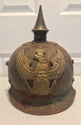

And this is what the JzP looked like when I got it....
Hey Pontrest,
They can be a lot of fun to restore.
Oddly enough, I have stripped old black paint off of a couple of M1915 cuirassier helmets in doing minor restoration over the years.
I have seen it on other helmets as well.
It made me wonder if black paint might have been period applied to some of these helmets for combat use in order to knock the shine off of them in the field during combat.
I really like your repro officer wappen on the first JzP helmet you are restoring. Where did you get it? It looks a lot better than the repro I bought awhile back.
And your work looks good! At least you will have something that presents well on a shelf in your "man cave" until you can acquire the correct original parts. Way better than a half finished project helmet sitting on a shelf! I like it!
Bryan.
