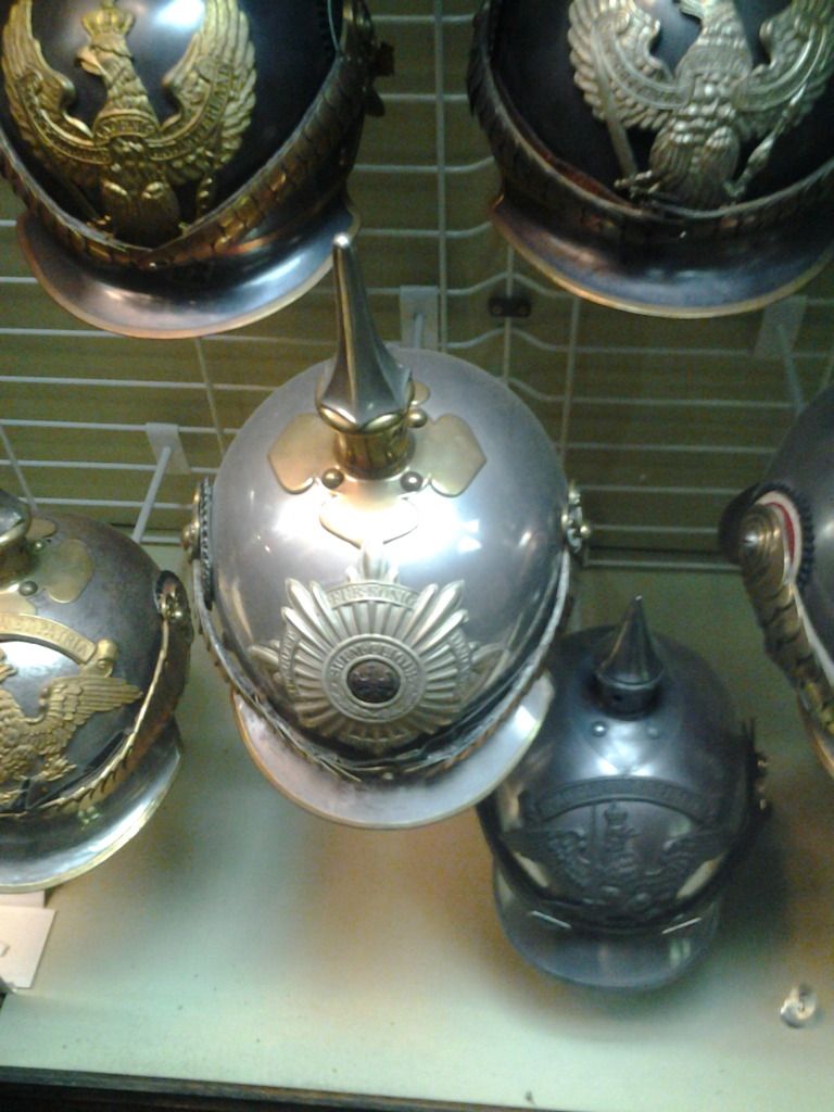

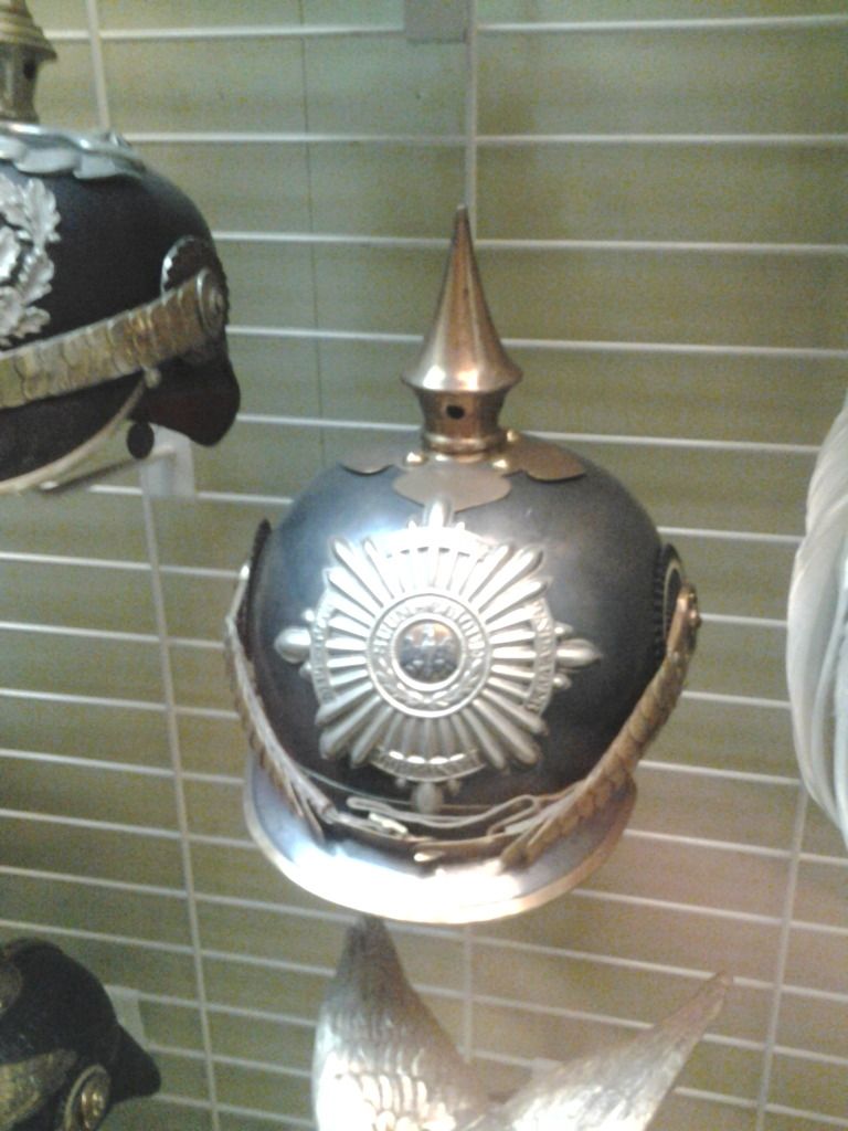

09fritz2547
Here in Brussels, in the fabulous Royal Army Museum, we have a similar helmet, I think with the double stepped visor and yellow mountings. I'll post a picture as soon as I can.
Johan
09fritz2547

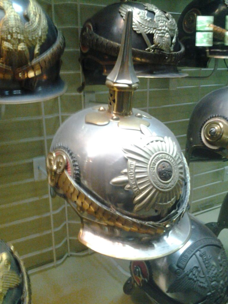

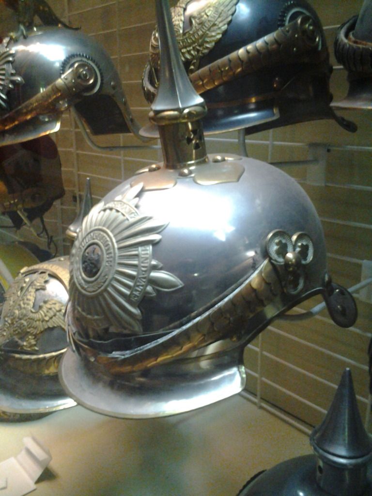

As mentioned before, the Royal Army Museum in Brussels has the same helmet. Notice the stepped visor (not double!). The Prussian Kokarde is missing, but there are clear markings there was one originally.
And here is the EM Garde Meldereiter.

Arran
Thank you for posting these pics! I wish we were able to see the rear neck guard, as I suspect that this has the one-piece style and is in fact a helmet of the Stabsordonnanzen Garde-Korps. There are some great pics of this type of rare helmet on pgs. 457-58 of Tom Stubbs' helmet book...

Thank you very much Johan! That one is a little bit more easily explainable because of the gold fittings. Is there some sort of literature or written explanation offered by the Museum?? It might be all wrong or it might be part right! Thanks again.
