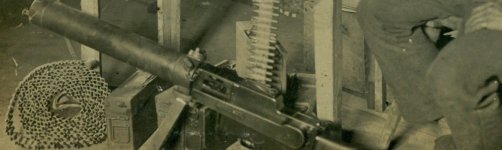

I am aware of three main bipod patterns used in WWI for the MG08/15. There are no proper names so perhaps the standard pattern, the ersatz/expedient pattern and the tubular pattern (as used with the T Gewehr). Here is an image of the expedient (which I am looking for). So any imagery details of any other variations - outside of trench patterns - would be very welcome.

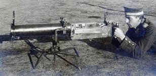

Clearly my image hosting does not work, so some images of 0815 bipods that I seek. Firstly the most common as seen in period images:
DF (149).jpg many examples were produced even close to the front line. If any members are aware of different patterns please let me know?
Always looking for the unusual mounts :>) but as you can imagine the variants of trench mounts are enormous. Unit armourers, field and echelon workshops and then add all the anti aircraft variations - lots to find!!!
