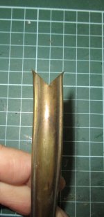

The wappen itself looks good but I have never seen slots like those cut into one. Perhaps, this was a JR 117 where two date bandeau would have been soldered ? The slots are located where these would go. The same goes for the prongs...longer and thicker than I have ever seen. The spine you need would have a slider vent but the end which goes under the spike arm would have a “V” cut out for the prong which goes through that arm to secure it to the helmet. Some photos:
The spine on my JR 115
A typical slider vent.
Although this is an officer spine, it shows you what the V cut out looks like. The V space allows the arms of the prong or shank of the screw post to go down through the shell to secure the base. All cruciform spike base helmets in my experience have this cut out in the rear spine. You will notice also, that the rear spine arm is itself shaped so that the spine fits underneath it.

Here is the wappen in place, I have not bent the attachment prongs back yet as all the hardware will need to come off for a final rub down and polish.
I have found an original brass rear spine with vent that is in pretty poor condition but with a bit of luck and a lot of work I will try and get it to fit.
