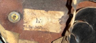

I believe it's another pre-1880s helmet given the liner type and the wappen being fastened with screws. Exciting but maddening is the label that gives clues but no clear answers.
I can deduce it reads Einjährig-Freiwilliger across the top and at the bottom is 4.Bat.Ostfr......something. And the name has H----l...
Anyone a psychic? I want to think Hillman or something like that.
Anyone know what unit that might be? I presume Eastern Front (Ost.Fr) and 4th Battery of a regiment that was on the eastern front. Also has the Feld Artillerie chinscales

Hi Peter,
Very nice helmet :)
"Ostfr." is the abbreviation of "Ostfriesisches", as in Ostfriesisches Feldartillerie-Regiment Nr. 62, the only "Ostfriesisches" regiment I could find.

Hi Peter,
FAR 62 was in X. A.K. in 1914, Stab and I. Abteilung stationed in Oldenburg, II. Abteilung stationed in Osnabrück. Not sure to which Abteilung the 4. Batterie would belong. Source: "Führer durch Heer und Flotte", Friedag, 1914.

FAR 62 was raised on 25.3.1899, so maybe the screws on the Wappen are due to this being a private purchase helmet rather than being an older model? Same for the liner.
