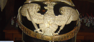

Today, another piece from Steve's collection IR 145 officer:
"Note this is NOT a Grenadier eagle with no star but a Garde eagle with no star." The wappen was changed when this Regt had Koenig added to its title. You can see the outline of the original wappen still on the shell.

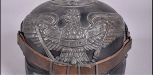

Some additional KIR145 pieces from steve's collection:
A Bambus style filz helme with rolled edges

Hello, great officer helmet - with the "Garde-Adler ohne Stern" (Guard eagle without star since June 1913) - as Philippe you still told!
Thank you and best regards, Jens
Here a picture with this kind of emblem.: Herman von der Heyde
... and a picture for Mannschaft - you see he is wearing the "normal" Grenadier-Adler (neuer Art).
