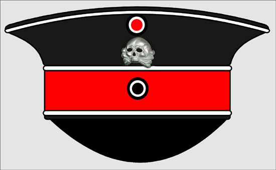

Could I ask you guys what you think of this template for my new cloth headgear reference? [-o< The reference pages will have separate pages for:
Evolution of the Imperial German Krätchen and Schirmmütze;
Colored drawings of all known types of pre-1914 Dunkelblau and post-1910 Feldgrau cloth headgear for all arms;
Tradition Badges worn on Imperial German cloth headgear, such as Totenkopf (skull), Edelweiß, Beamte etc; and
E or Eigentum (property) Stamps in headgear.
Großherzoglich Mecklenburgisches Jäger-Batl.Nr.14 (Colmar i.E.) XV Armee Korps
Does the Schirmmütze look good?
Hi Tony:
As a graphic representation of a Schirmmütze, I think it's just about perfect. Are you able to flatten the Teller a bit?
Chas.

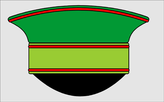

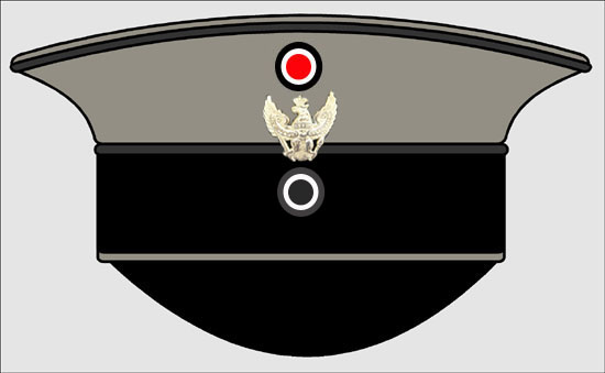

Very cool project. I'm sure these are prototypes, but will you add in the state and national cockades? Also, in the final product, I presume the piping will be corrected (ie. no band color above upper piping and the band piping below the lower piping will be changed to the color of the"schirm" portion of the cap). I would also suggest that even if the band and piping are the same, still show the upper piping and show the schirm color below the band.
Dave
dave mosher said:
//will you add in the state and national cockades?//
Thought hard about that, my plan is to not place Kokarden on the caps, as in the example below, it was worn by two Preußen Dragoner Regts and one Württembergisches Dragoner Regt. With Kokarden, I would have to place two caps on the page. For Infantry it would go on and on with the same colors. So I was going to focus on placing one only of each color combination.
dave mosher said:
//I presume the piping will be corrected (ie. no band color above upper piping and the band piping below the lower piping will be changed to the color of the"schirm" portion of the cap)//
Oops! Got carried away with the fill color. I have removed the band visible above the top band piping (drawing mistake), and grouped the lower edge cloth below the lower band piping to be the same color as the top of the cap. Is that better?
dave mosher said:
//I would also suggest that even if the band and piping are the same, still show the upper piping and show the schirm color below the band.//
Good idea Dave, as the bottom of the band normally does not have piping if the cap band and piping are the same color. I have done this with the example below. Better? Once I get approval here on the template, I will start hammering out the caps for the reference. How does this look now?

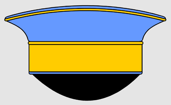

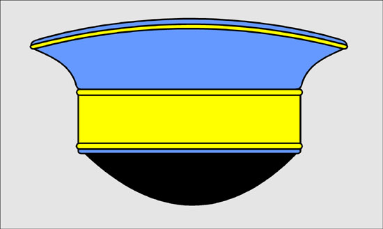

I really like what you have done! I'm not sure if this is the case on the pre-war caps, but on the feldgrau caps where the piping and band are the same, only the top (upper) piping is used. Also, your reference would become incredibly useful for cap collectors if you are true to the actual colors. Be very careful with your shades of yellow, red, pink and blue for your cavalry units. IMO the yellow you show above is a "zitonengelb" used on DR21 and DR4 for pre-war caps. A "goldgelb" was used for DR8, DR16, DR26, GUR1, GUR3, UR11, UR15 and UR20.
Dave
dave mosher said:
//Be very careful with your shades of yellow, red, pink and blue for your cavalry units. IMO the yellow you show above is a "zitonengelb"//
You are correct of course. Just learning the program....OK...think I got the yellow right this time. Above would be zitonengelb (lemon yellow) and below would be goldgelb (gold yellow).
