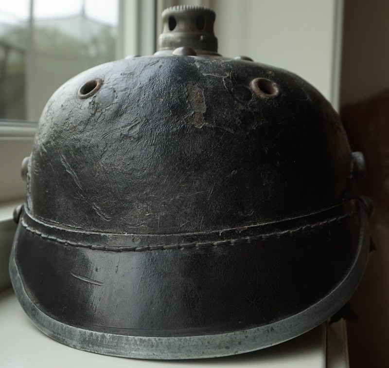

Those of us who have been collecting for a long time and have handled hundreds of helmets know that many M15 helmets were in fact converted/repurposed M95's. The brass fittings were stripped off, including the grommets and replaced by feldgrau/grey painted steel fittings. Recently, I purchased such a helmet and discovered that it could be used here as a great example of how helmets were recycled by the Imperial Army. The Prussians were very serious about saving money whenever possible. The following pictures of my new M15 Prussian helmet prove this:
The helmet came with an original spike, chinstrap and cockades but these have been taken off. From the front, it looks like the typical M15.

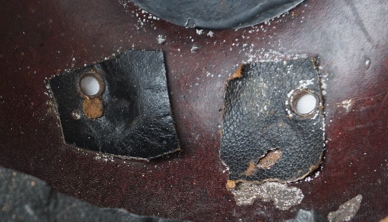

Now lets take a look inside the shell:
Original thin black leather patches reinforce the "new" steel grommets that were put in.

I have one that is very similar. My first Pickelhaube, given to me by a father of a friend. I've always been very grateful to him, as having a Pickelhaube to look at and compare with helped me to avoid fakes when I bought subsequent ones online.

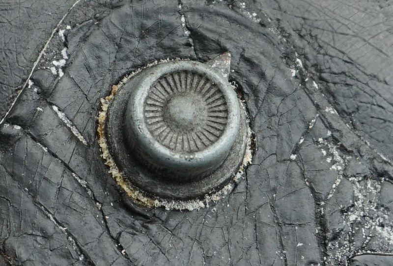

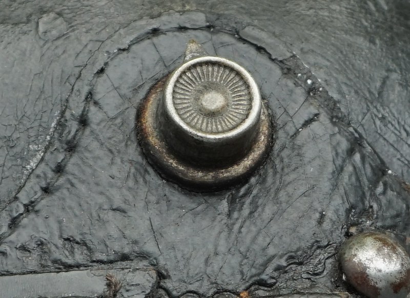

It shows the same plugs and patches for the grommets, the shell was shortened, and new Vulkanfiber Vorder- and Hinterschirm were stitched on. The stitching of the previous Ohrenleder is still visible on the inside, and shows that the shell wasn't shortened equally on both sides. When resting the helmet on the visors the rear visor keeps the helmet level, and it becomes clear that the front visor has been stitched on crooked. To finish it off, the Knopf on the left is steel, and the one on the right is made of some sort of alloy. Not quite up to the standard of Pickelhaube manufacturers :wink:

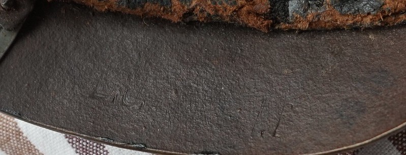

At least the men responsible nicely stamped the rear visor with B.J.A. XVIII.f. (Bekleidungs Instandsetzungs-Amt XVIII, feldbrauchbar)

Crooked Vorderschirm
Patches inside plugged holes

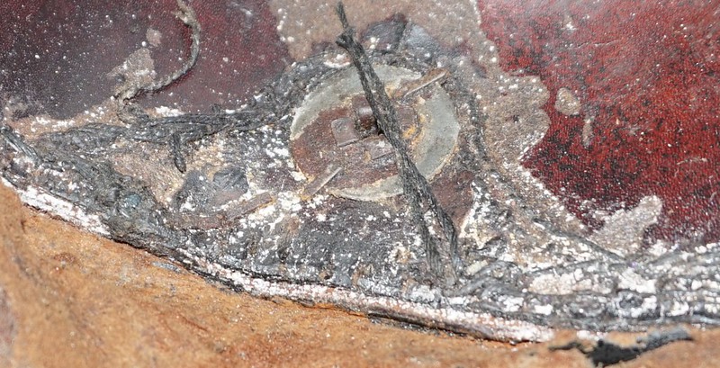

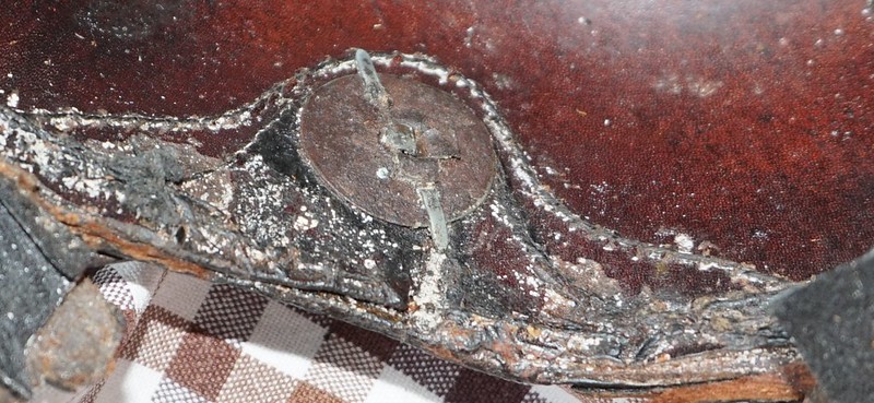

Inside right Ohrenleder
Inside left Ohrenleder
Left Knopf alloy
Right Knopf steel
Stamp B.J.A. XVIII.f.
