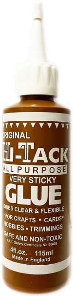

I use this technique on all the uniforms and hats I repair.I place a transparent foil over the hole and trace it with a marker.Then I place the pattern on the material and cut out the desired fragment with small scissors.I glue the fragment in place using English glue. It is important to press the patch with a rounded object using back and forth motions after gluing.I repair items with original material. If I don't have it, I don't repair it.

Thank you very much for the reply and information. Would you happen to know if the glues will light up under inspection with a black light.
Just curious, I've had a few items over the years that had been glued in hidden areas such as under cap liners,ect. And they glowed like something from a CSI crime scene.

I shone a UV flashlight on the object. I use a flashlight to search for amber on the beach at night. Neither the glue nor the repair materials illuminated.
I use this technique for smaller holes.
