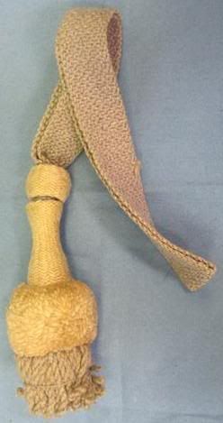

Which of the following 2 knots would you go for to complete a Prussian-proofed wartime S98/05nA bayonet?
Knot 1:
> Is this a 1. Batt. 1. Ko. Troddel?
> Seller says it is soiled white & the strap is short hence a wartime model... true?

Ron,
That first one looks all yellow, which would be the 11th company. The short gray strap is wartime.
Forget the second one. :wink:
Chip

Just wanted to share with you that great looking 1st Infantry Co. wartime (short pattern gray cloth strap) troddel I finally found the energy to photograph... It is in close to mint condition--despite some age soiling--with its ends still tied with the factory string.
A question though: Since the bayonet I'm displaying it on is a Prussian 1916 S98/05 nAS (Säge/Sawback) version, with no regimental markings, would there be an issue? (1st Inf. Co. knot vs. non regiment-attributed sawback bayo. usually issued to Pioneers)?
