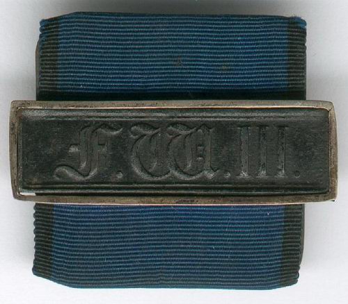

There is a similarity in design between the pre 1913 2nd Class Landwehr Officers' Long service decorations (ie. a rectangular clasp surmounted on a broad ribbon) and the pre 1913 non-commissioned officers' long service awards. Here is an example of a Prussian NCOs' pattern 9 year long service award. Bearing in mind your Grenadier's tunic was neither that of a non commissioned officer or of a re-enlisted solidier (Kapitulant), it's owner would not have been the recipient of a long service award.

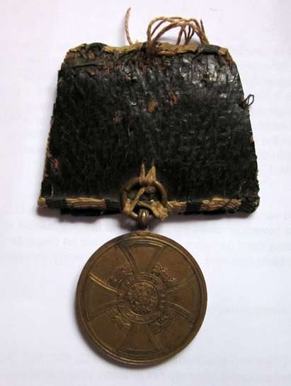

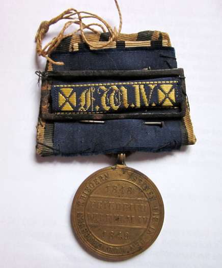

Next up is this oldie attached directly to the ribbon of the 1848 Revolution medal, 1848/1849 Hohenzollern Denkmunze fur Kampfer. Mounted to its black/white ribbon is a Landwehr award bearing the initials F.W.IV, (Freidrich Wilhelm IV 1840-1861), maybe I just answered my own question. Interestingly the medal itself is mounted backwards on its suspension. Further, according to one source, the ribbed suspension ring indicates manufacture at the Royal Mint at Berlin .

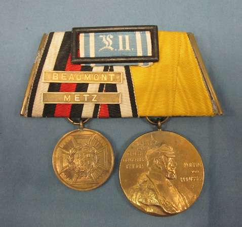

Next is this very nice Bavarian example mounted to a two-place medal bar showing the 1870-1871 Campaign Medal & Centenary Medal. It has the initials for Ludwig II, the Dream King, who reigned from 1864-1886. Do Bavarian awards post 1886 display other intitials?

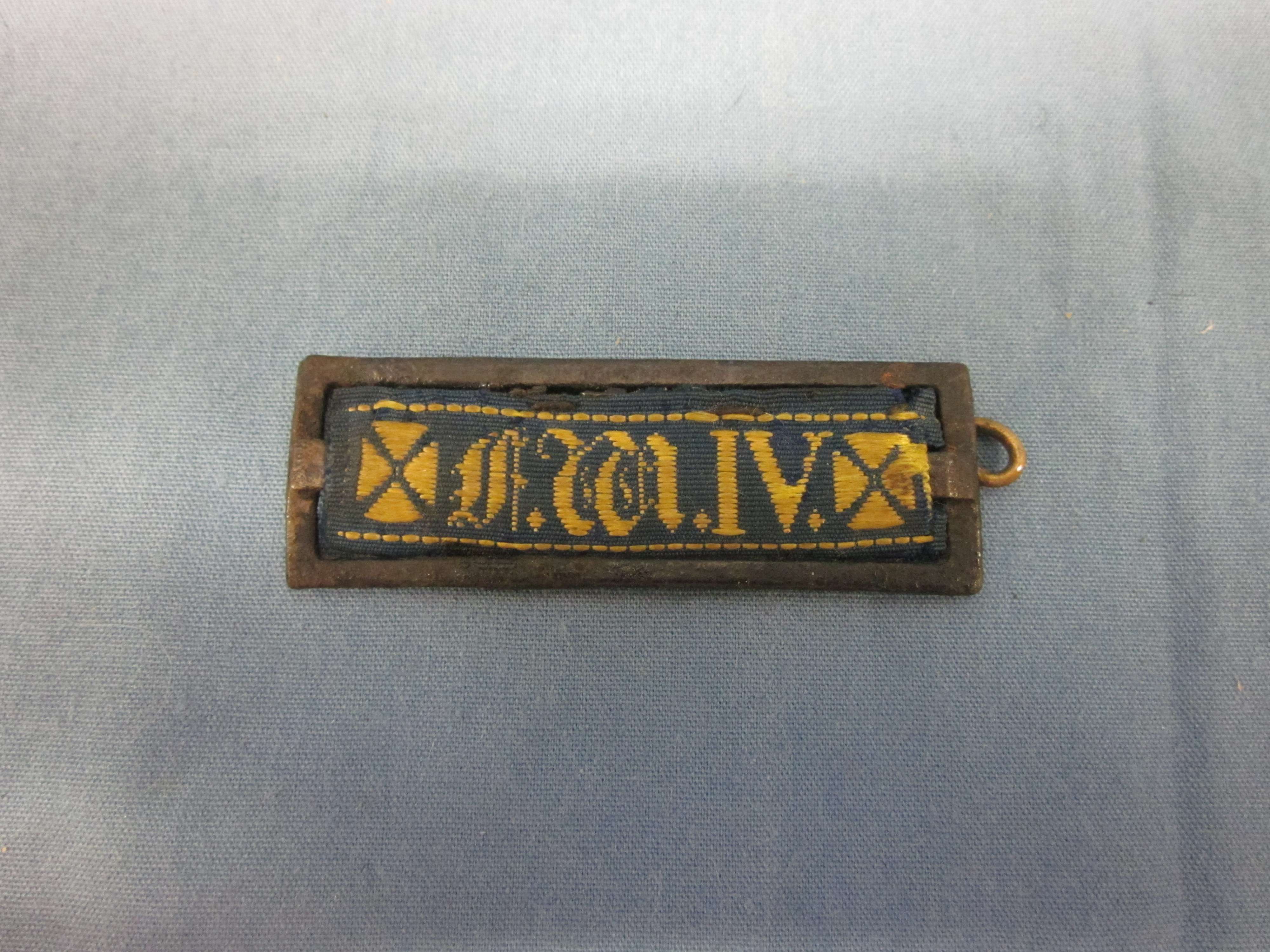

Another old soldier, F.W.IV, this time by itself and missing its mounting pin but retaining its black metal frame.

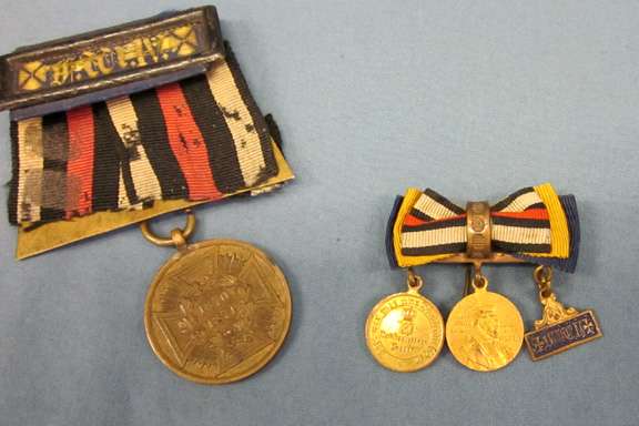

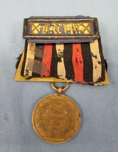

For fun, a miniature three place bar with the Landwehr bar displaying the F.W.IV initials. However the Centenary medal was awarded in 1897, well into the reign of Wilhelm II.
Lastly, a well worn 1870-1871 Campaign Medal with bar attached directly to the ribbon, it also displays the F.W.IV initial. With the Campaign medal awarded during the reign of Wilhelm I.

its a big subject but to start off with in the case of the Prussian Landwehr Decoration 2nd Class. It was instituted in 1842 and had the initials FW IV (Friedrich Wilhelm IV) and continued to be issued with those initials until replaced in 1913 by a small medal.
The NCOs' Long Service Decoration was instituted in 1825 in three classes during the reign of Friedrich Wilhelm III and had the initials FW III. Like the example above these continued in use until 1913 when they too were replaced by medals.
The Bavarian example you posted was instituted in 1876 during the reign of König Ludwig II and continued to be issued with his initials during the reigns of his successors unaltered.
