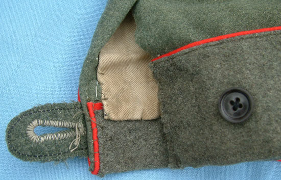

Hi George:
I can't quite visualize the distinction. Perhaps this photo will help you identify the cuff pattern:
As for the other points you raised, the lining is polished cotton Feldgrau, the waist is tapered, and the belt ramps are sewn in. Both halves of the internal belt are sewn directly to the lining; therefore, it doesn't really function as a cinch.
I purchased the Feldrock in 2003. Had I known it would be this interesting, I would have posted it sooner.
Chas.
Sorry Chas, now I am confusing you!
On the back of the cuff, does it look like the one at the left (M1907/10) which buttons flush, or the one at right (M1913) with the small loop extension?
Wylie
the cuff on the left is tucked in the tab is just visible, I might be wrong but I can see the little tab , the button is missing.
mark
Hi George:
The back of the cuff looks like this:
How closely would a private purchase Feldrock worn by an officer and the issued Feldrock conform to one another with respect to the M1907/10/13 patterns?

Chas
Everytime I open up this thread, I can't help but look at all the pics first before I check your reply, just so . . . nice.
Thanks for the extra pics of the cuffs, believe it or not, I have learned a lot from this thread, having known practically zip before hand. In the future I will be better prepared when finding one of these. I would never have realised I would be looking at a private purchase vs. standard issue and all kinds of sparks would have been shooting out of my ears.
Zippy, thanks for clearing that up, was not sure what that was in the pic. So one last question then, on a standard issue M1907/10, the cuff would be like this one in Chas' pic then?
Excellant thread with outstanding photography, thank you so much for sharing this feldrock.
Geo
Wyliecoyote said:
// The 1913 added a small loop extension. //
Is this what you are talking about? This is discussed in Kraus, J. (2004) The german army in the first world war.Verlag Militaria, Vienna p.142.
You should never find an opening cuff on a private-purchase tunic. However, being private purchase, the guy could order what he wanted. So no doubt they exist, but as a rule-of-thumb, opening cuffs are a feature of issued tunics.
Wyliecoyote said:
Is this cuff on a M1913 or an updated M1907?
1913 version. I realized from this discussion my M1907/10 Feldrock page was out-dated, so I updated it HERE. I also added some uselful things like shoulder straps Corps piping etc.
