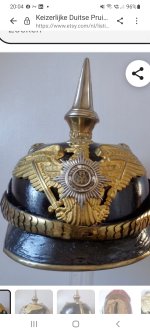

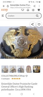

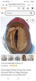

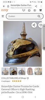

I am a novice collector and lover of pickelhaube and new to this site/forum.
I get the chance to buy a Prussian general helmet for 1800 euros. I know they normally do between 2500 and 4500. According to the seller, everything is original. attached the photos. I would like to hear your opinion on this?

as far as I see it looks ok for me. But I would request more photos of inside and the leather of the chinscales. Because of the high rosettes it seems to be a M15. The seller is from UK, so regard evtl. customs.

It might be a Prussian 1st Garde Dragoner officer helmet, to which a fluted (ill-fitting) spike has been added. This is not a spike for a general helmet though. See below for a real one. In addition, colours don't look right: are the cruciform spike basis and the spike itself made of white metal ?... All fittings should be in gold colour. Does the eagle plate belong to this helmet? Have you seen the reverse aspect and shell behind ?
The spike does not look to be a general's helmet spike. It looks like a bavarian officer spike.
A general's spike is rolled on the bottom like in the above picture...

Ik zou als ik jou was eerst betere foto's willen zien, maar mijn eerste gevoel zegt dat het niet goed zit.
(In english: If I were you, I'd like to see better pictures, but my gut feeling tells me it isn't right.)
Too many questions about this one, I'm afraid.
